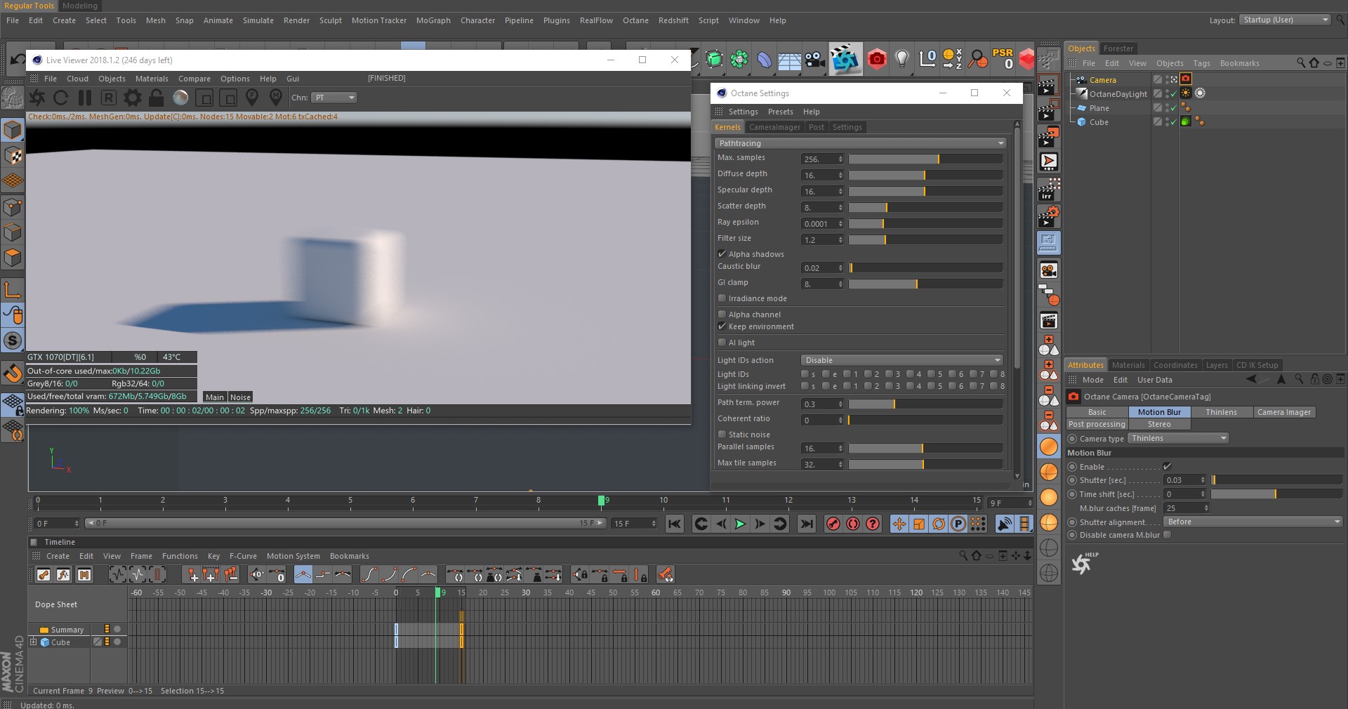

Octane doesn't seem to render motion blur on weighted / skinned models in c4d. Running latest vr.

I discovered while trying to render MB on a weighted / skinned character in an animation -- but here's a simple cube example with similar results. One before and after weighting etc...
Blur
Blur
No Blur Weighting / Skin

you have to select vertex/transform motion blur
