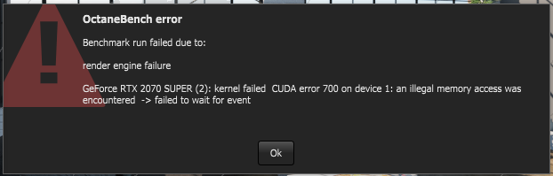

I just set up my new Workstation and get several Errors:
In Octane Benchmark 4.0 i get the Cuda 700 Error (see IMG).
In Cinema 4D R20.059 with the latest 2019.1.5 Octane Plugin I get another error (see Logfile)
Nvidia Driver Version is 441.66 WHQL
The strange thing is that it only happens when both cards are used for rendering, Each card alone works perfect.
Also the rendering starts normal and after 20-50 passes the errors occur and it stops.
I did a lot of (gaming)benchmarks. System stays cool, fast, stable. No problems.
The GPU´s are slightly overclocked by msi afterburner.

please, try to go to Nvidia Control panel, menu Help, and enable the Debug Mode, to run the GPUs at default clock. ciao Beppe
