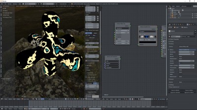

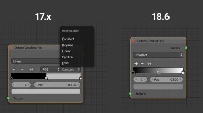

Gradient node has missing interpolation options compared to previous releases. The Interpolation that are there doesn't seem to work.

The missing interpolation options shouldn't have been there since ever, since you can only use the onesyou can find in Octane Standalone (Cubig/Constant/Linear).

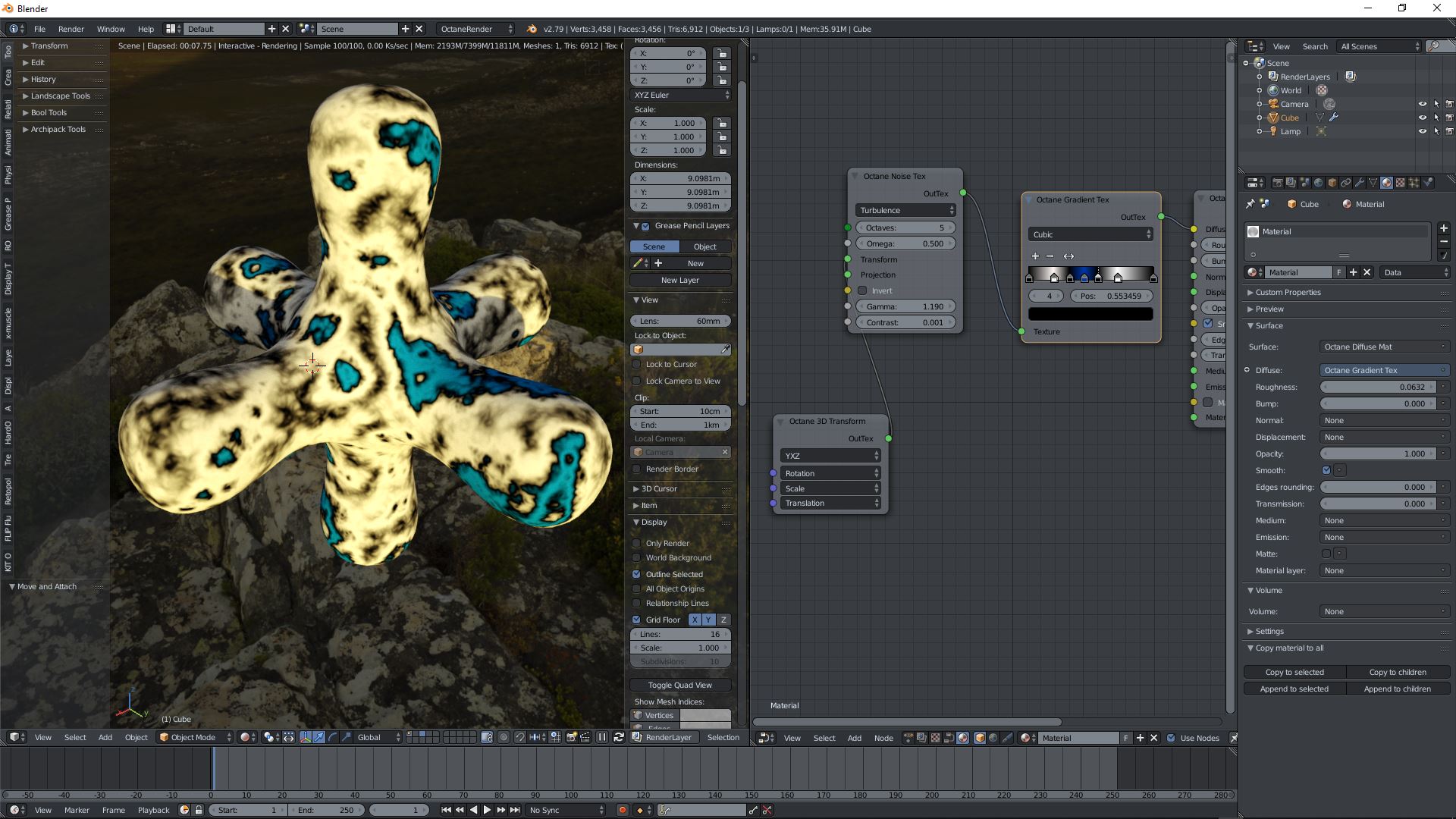

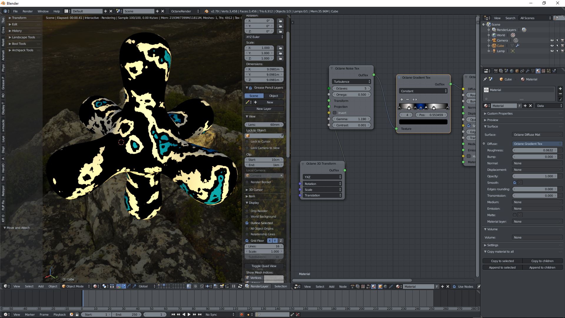

Current interpolations modes seem to work fine here. Do you have a scene showing the issue?
Cubic: Linear: Constant:

Strange but after launching Blender today the Gradient nodes look the same as in 17.x
The interpolations also work as expected on the render view.
