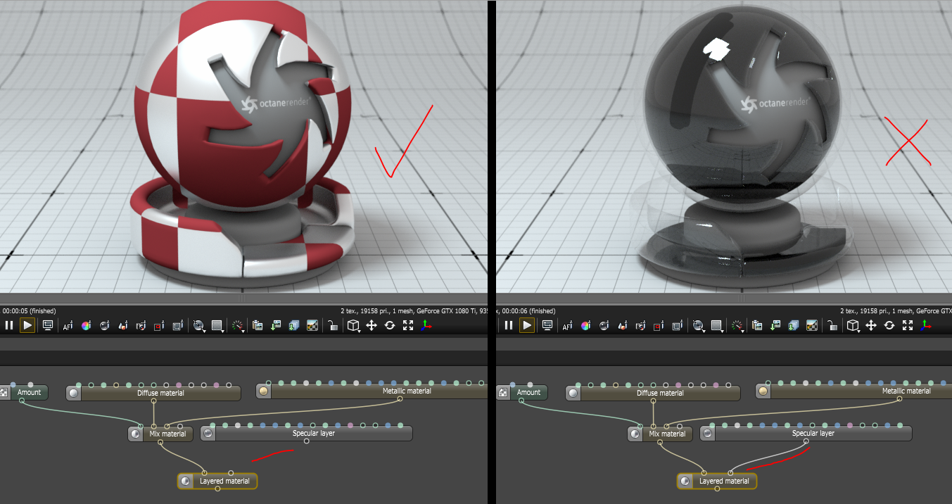

Layered materials dont seem to work correctly if you have a layer, and the BASE MATERIAL pin comes from a MIX or COMPOSITE material

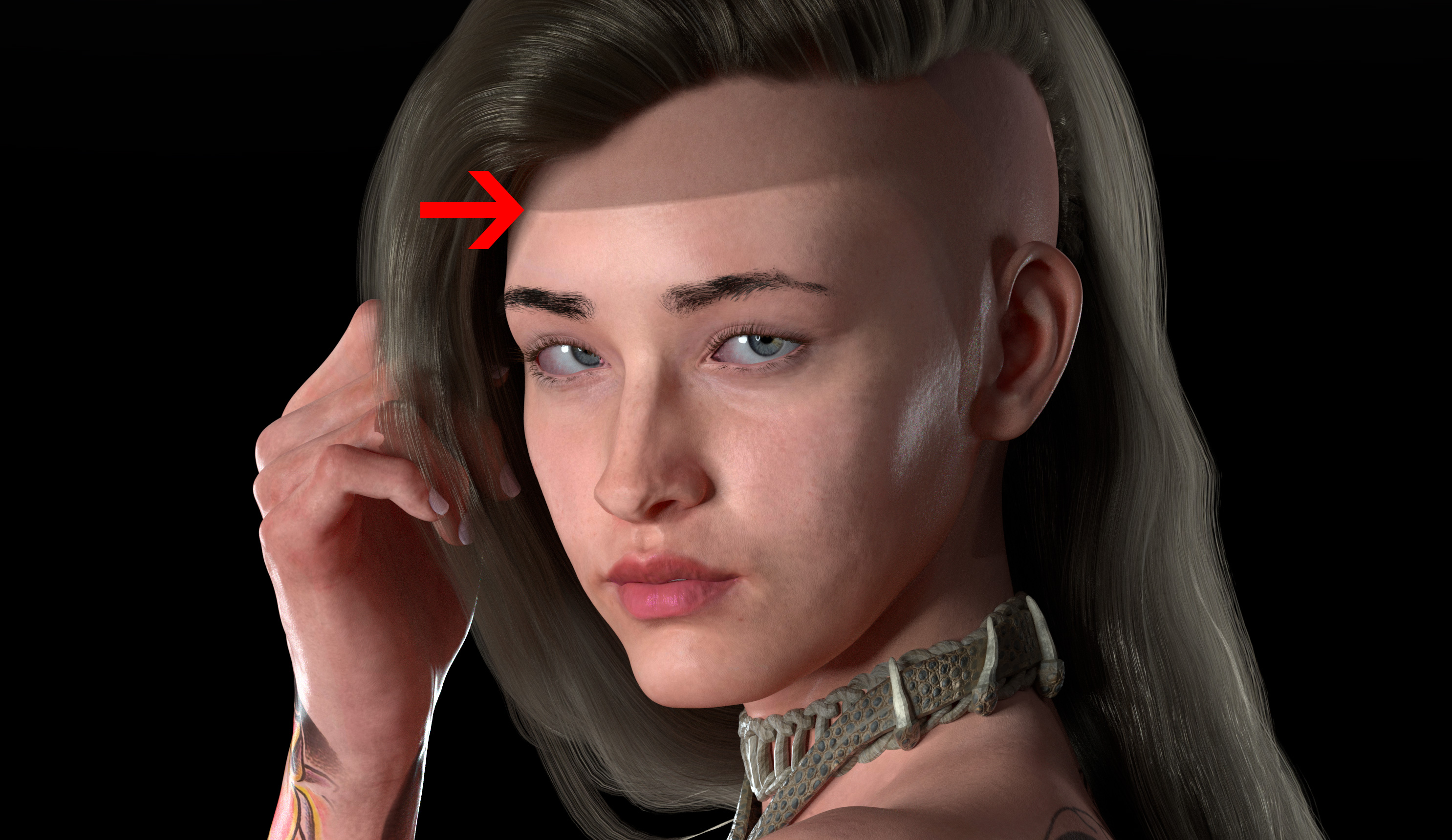

There seems to be a problem with alpha-mapped objects casting shadows onto random walk sss-enabled geometry.
The shadow in this scene shouldn't be visible, since that part of the alpha map (read: the haircap) is transparent. Yet, it is casting a shadow.

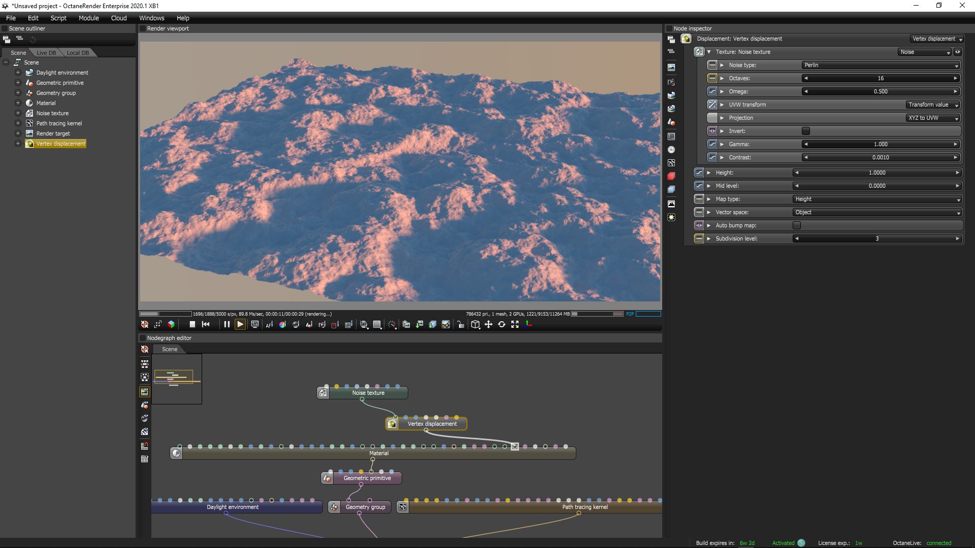

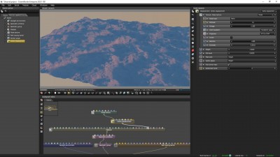

Would it be possible to add an AutoBump value to the Vertex Displacement node? That's something that needs to be controlled by the user (especially considering that Vertex Displacement is totally ignoring any texture connected to the Bump input of the material right now, as long as a procedural texture is used for displacement).
This is Vertex Displacement applied to a plane, with AutoBump off. This is the same plane with AutoBump on. Thanks!
