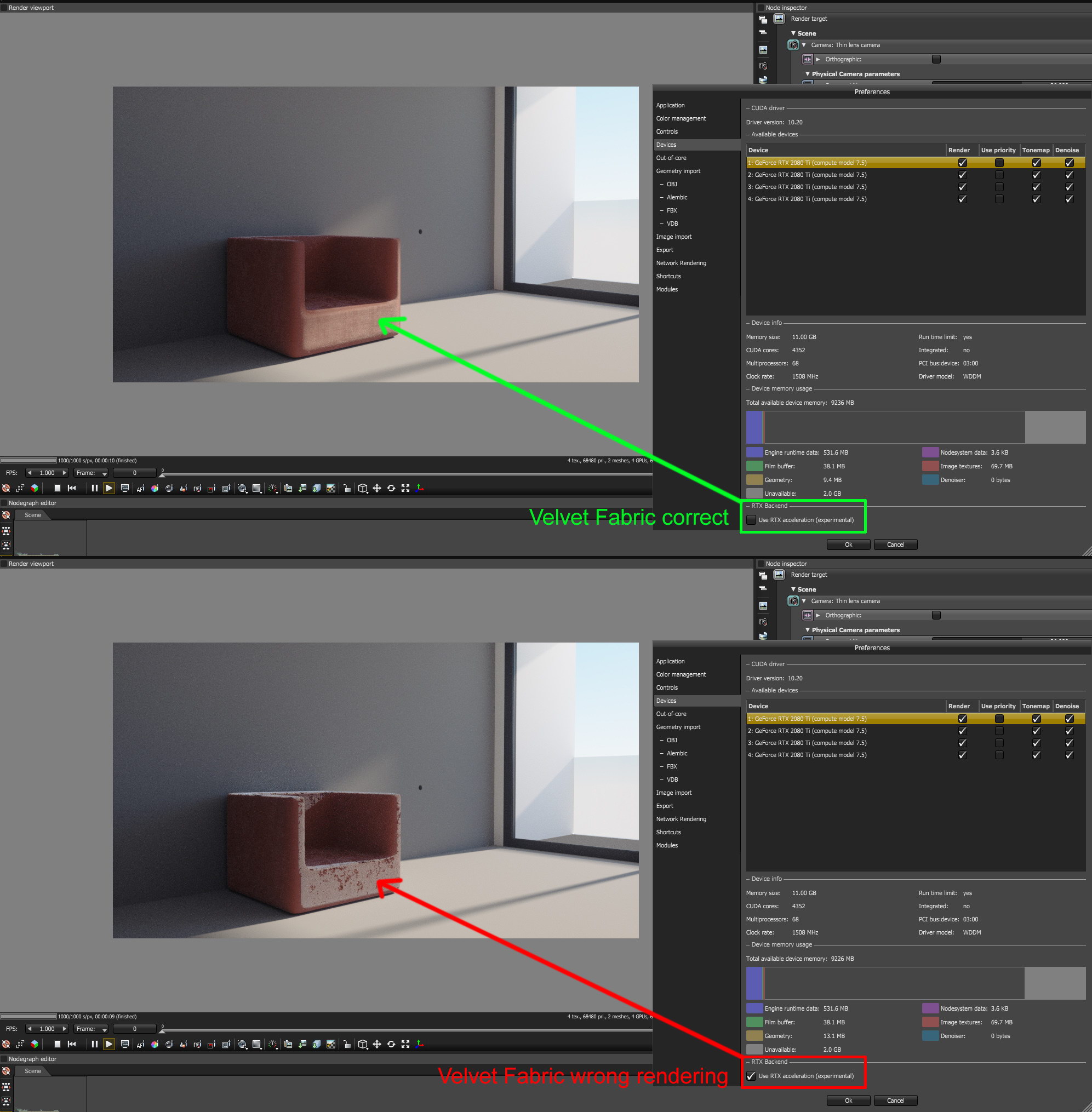

Hi Again,
I think i found some bug in rendering material with RTX ON.
Here is the simple scene of armchair in simple room. Test with RTX OFF show All good, and with RTX ON my Velvet Fabric is rendered wrong (looks like inverted mix material or so?).
But what is weird here is that IF i put this Armchair outside of the room (just at plain sun) then it's rendering fine with RTX ON also, so it might be some weird combo with windows glass (Fake shadow) + RTX ON and some material settings.
I hope DEVs can find way to debug it properly form this scene, I simplified it as much as possible.
attaching image and ORBX
RTX_Velvet_Glass_BUG.rar

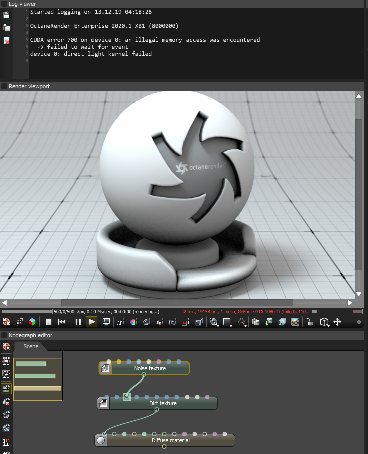

Plugging a noise texture into the dirt radius crashes Octane
dirt_radius_texture_crash.ocs
(37.01 KiB) Downloaded 322 times
