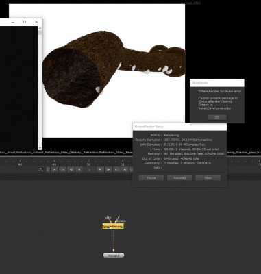

Imported orbx file generated from C4D R19 into Nuke
Everything is looking fine. However when I click 'Import Geometry' to get geometry into Nuke to see in 3D it throws an error
OctaneRender for Nuke error
Cannot unpack package ......
Nukex 12.0v2 - Octane plugin error while Import Geometry

Hi. This function loads an actual .obj file into the Nuke scene for visualisation purposes. However the .ORBX format has these assets packed inside the ORBX file, and they are not actual files on your filesystem. I will see if I can enhance this function in the next release to extract the .OBJ files from the ORBX prior to loading them into the Nuke scene. In the meantime, you can load your ORBX into Octane Standalone, the File->Unpack Package, then manually load the .OBJ files into Nuke.
I hope that helps.
EDIT: "I will see if I can enhance this function in the next release to extract the .OBJ files from the ORBX prior to loading them into the Nuke scene." - this is not so simple, as unpacking the assets would change the Octane Scene in the plugin, which may have undesirable consequences. I think a better option might be to add a button called "Unpack Octane Scene Assets" which copies the assets from the ORBX onto your file system. I will investigate this option.

I have used Octane Standalone to unpack ORBX which generated OCS and assets. I loaded OCS into Nuke and then did 'Import Geometry'. This brought all geometry into Nuke 3D at right coordinates. This is good until you get to do this directly from ORBX.
