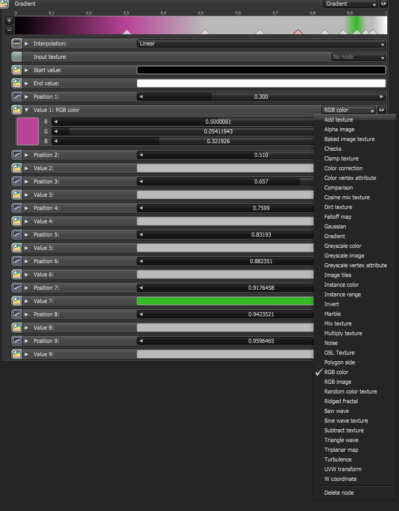

In standalone Gradient texture has multiple inputs for position and value. In plugin for Octane it has only one texture input.

Hello DrawFun,
I know how gradient node works. I'm saying it has only one input while in Standalone or C4d plugin you have have multiple inputs and plug any texture you want to those inputs.

That's more a limitation in Blender's node system.
It would be awesome to be able to plug a different texture in each "texture" input and animate the position of each key.
We should investigate if creating a proper node is possible or not.
