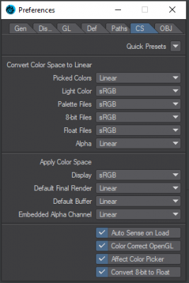

so Juanjo this panel not work??
i see the color variation if change it.
how can disable it?
how can disable it?
