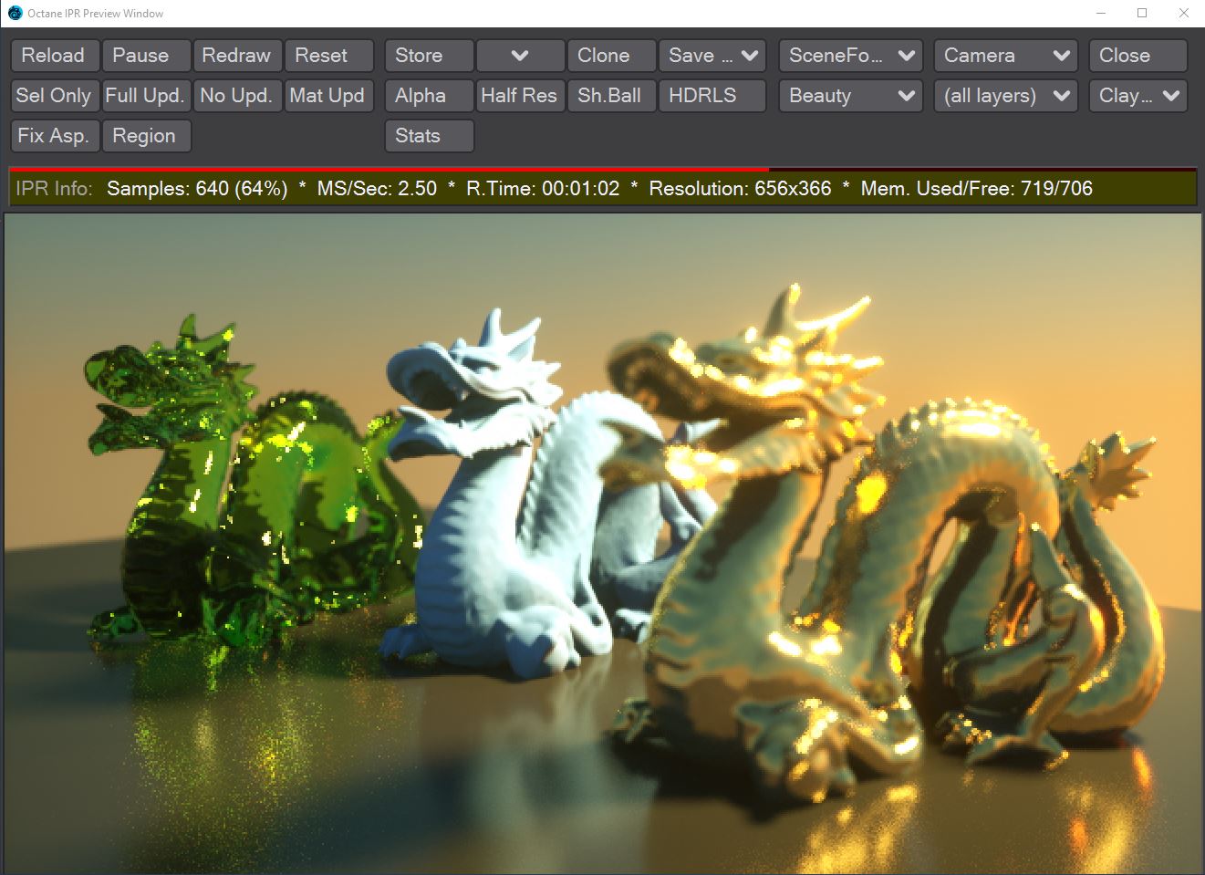

Hmm, well, what LW does is to scale the GUI. What is exactly your problem? Attached you have the IPR scaled 2:1 using this new LW feature that seems fine.
Of course, the OpenGL widget (that is like any other LW widget, like the buttons an so on) used to display the Octane image is also scaled 2:1, so technically the render resolution in my case is half the physical window size ... if the GUI scale is not an integer value (for example in your case 1.2:1) perhaps you could get some aliasing effects due to the GUI scaling, but I'm not sure if I am going to be able to do something about this. The GUI scaling is done automatically by the LW GUI system, and this includes the Octane IPR window.
