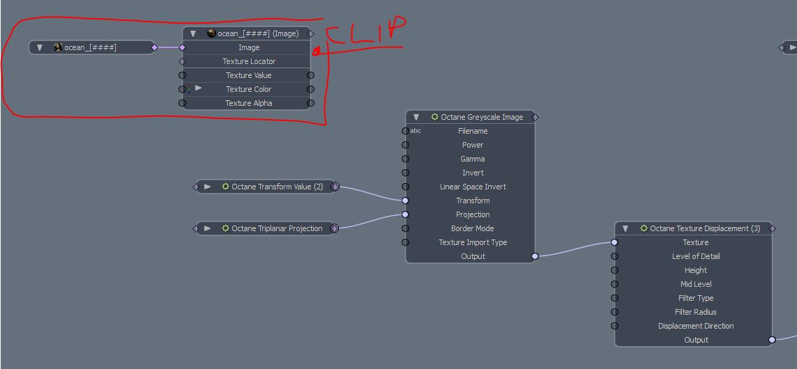

Is this still a problem?
I have a displacement map I'd like to use on a plane that I've shaded to look like water. Only thing missing now is to get the displacement working!

- Added support for Modo Image Sequences in Octane Overrides. To use this, drag the image sequence clip into the Octane Override schematic panel, and then connect the "pattern" chanenl to the Image node filename pin
I don't see a pattern channel anywhere.
I tried connecting any and all channels from the pins from the two nodes that came by dragging the clip into the schematic, but none will connect.
Add the "pattern" channel to the Image Sequence node, and then drag that channel to the Filename pin on an Octane RGB Image. I will get the Octane plugin to auto-add the "pattern" channel as it does the "filename" channel in the next release.

Add, as in "add user channel" ? Terribly sorry if I look stupid; could you share a screenshot to explain ?
In the schematic, rightclick the Image Sequence node ("ocean_[####]" in your screenshot) and "Add Channel"->"pattern".
