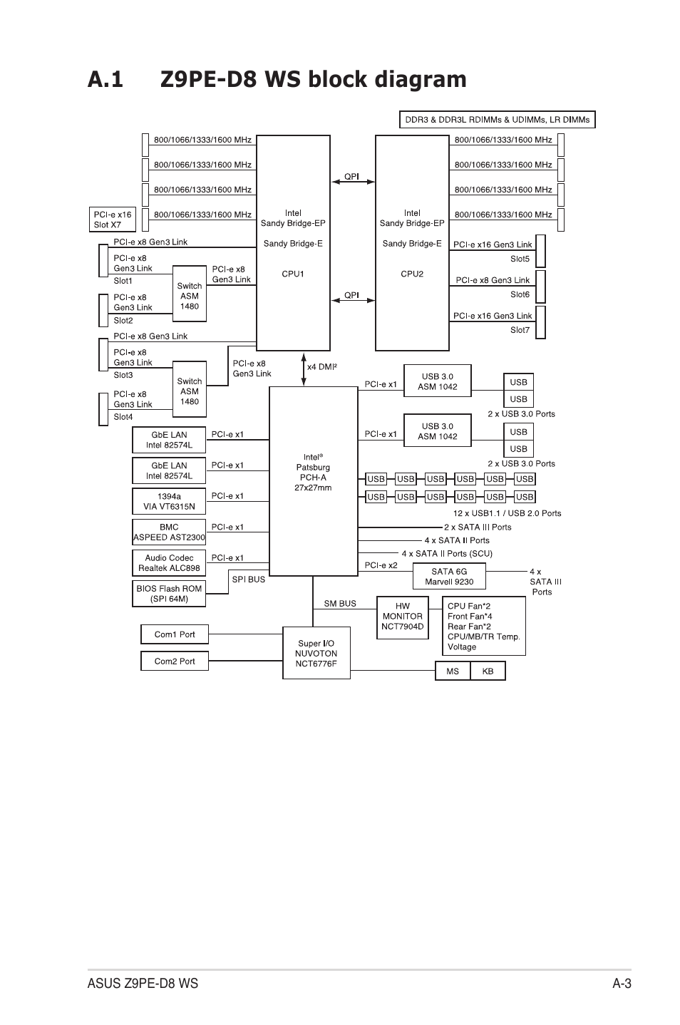

After looking at Threadripper motherboards for a while, I remembered that I have an Asus Z9PE-D8 WS board currently underutilized in another machine that I could use for this project. Both CPU sockets are populated, which means iirc that a total of 80 PCI-E lanes are available. I am including the block diagram for the motherboard below :
As it is, the board has 7 x16 physical slots, but some of them, like slots 1 thru 4 are already connected to switches. Slots 5 thru 7 however, are not connected to switches. Using an Amfeltec x4 to 4 x x16 PCI-E splitter on that last slot and risers on all others could allow me to potentially connect 10 GPUs. I have read threads on this forum where people talked about successfully using these splitters, and so while they are pricey, they seem like a safer bet than another brand.
https://www.amazon.fr/voies-X4-PCIe-ver ... 156&sr=8-3
Does this seem like a reasonable proposition ?
Antoncromas
Posts: 43
Joined: Fri Oct 05, 2018 3:53 pm
Hey,
Yes most boards now have only 4 x16 PCIE slots sadly. That may change when the latest 88 lane chip from AMD comes out but I doubt it.
Most elegant solution is to use x4 external boxes likes of Cubix. You can get them pretty cheap on ebay and they have capacity of storing 4-8 GPUs and plug into your motherboard PCIe ( I believe its a PCIe card from cubix with external connectors)
