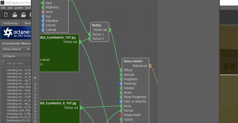

I have an issue with Octane pop-out windows such a viewport and Node Graph. Sometimes when dragging the window around screen, a part of it can get lodged past the visible part of the screen. When this happens, the "x" that allows you to close the window becomes hidden and makes it impossible to close without resetting your Daz to factory settings. Any workarounds for this?
Edit: This is a Daz related bug and not Octane. I've found a solution so leaving this post here for future reference. Go to Windows -> Workspace -> Off Screen Pane Groubs (Tab) and press Accept.

Hi tapanojum,
You can also click any where on the popup window and then press ALT plus F4. It will close the window for you.
Regards,
Rajib
