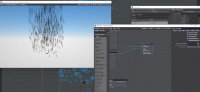

You have to turn on motionblur for instances. Also enable motion blur in the LW camera settings.
You won't see motion blur in the IPR window only on F/9F10 renders
Win 7 pro 64bit GTX780
juanjgon
Posts: 8867
Location: Spain
Yes, the instances and mesh deformation motion blur is available only in the final F9/F10 rendering. The IPR can't render the motion blur from these kinds of objects.

Any news for Octane particles in LW yet? Instances do have their limits numbers & speed wise.

NemesisCGI wrote:Any news for Octane particles in LW yet? Instances do have their limits numbers & speed wise.
Not yet, but it is one of the planned features in the short term, probably before the end of the year ;)

NemesisCGI wrote:You have to turn on motionblur for instances. Also enable motion blur in the LW camera settings.
That unfortunately doesn't work in LW 2015.3, limitation of LW's sdk :)
NemesisCGI
Posts: 111
Joined: Sat Apr 06, 2013 3:18 am
That version is over 4 years old now. There's a lot added to LW2019.x
