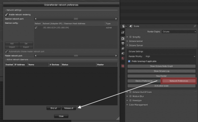

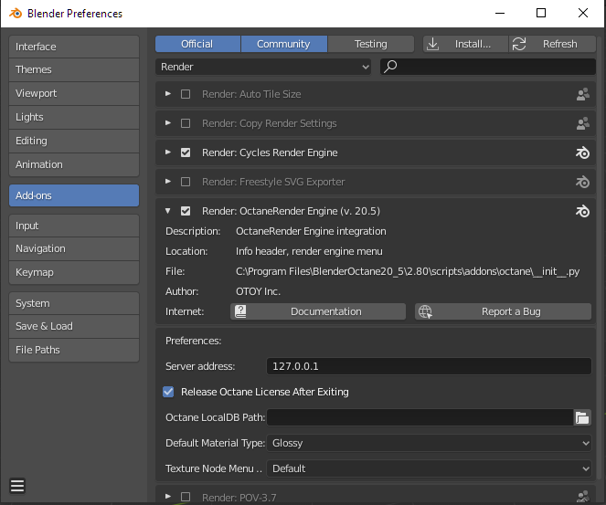

To make sure the license is released automatically when Blender quits make sure "Release Octane License After Exiting" is enabled:
You can manually release license using "Release all" option in network preferences:

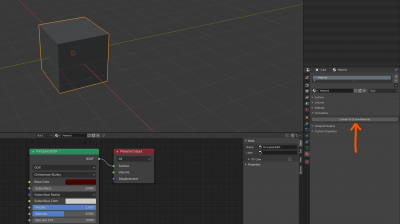

Hi ....you are awesome!!!!
Where is located de converter? :?
J.C
Posts: 1860
Joined: Thu May 13, 2010 6:35 pm
Location: Wrocław
Converter is located in material tab.
