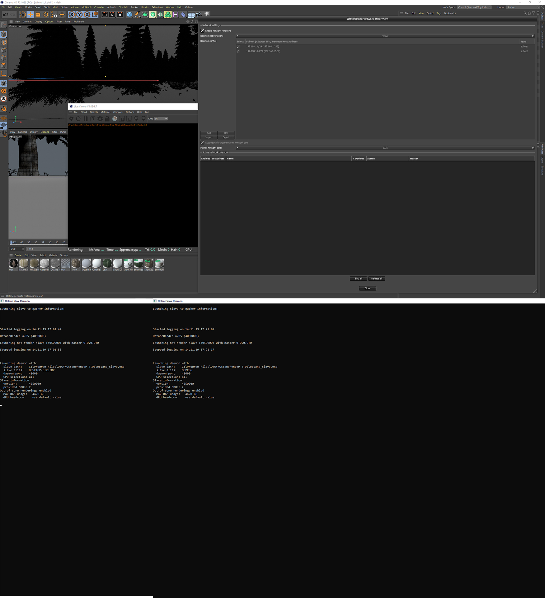

I'm trying to get network render going with Octane V4.05 R7 and C4D R21.026(RC)
The appropriate daemons are running but, on the master computer, they are not being detected. (see attached image)
Any ideas?

Most likely you need to give the daemons the appropriate permissions in Windows Firewall to access the network.
viewtopic.php?f=30&t=60607

Thanks for the tip frankmci.
It was indeed, though not the salve daemon but R21 itself.
