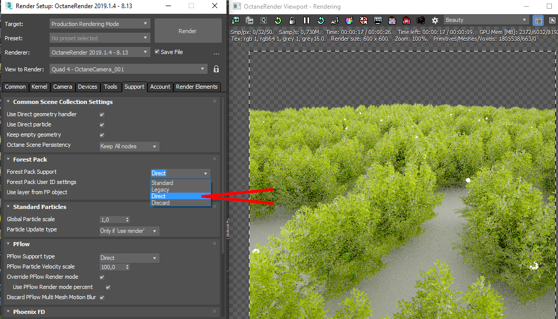

  • Fixed Forest pack unnecessary update on frame change.

- Updated Forest pack support.
- Added 'Support' tab in render settings, for common settings and external plugin configuration. Those are now scene specific, with default values editable in Global preference.

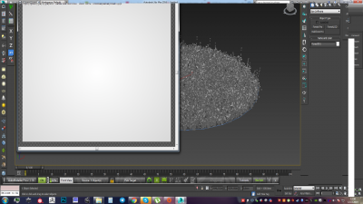

ForestPack doesn't work anymore...had to revert to 8.12. Then all is fine again.
PURE3D Visualisierungen
paride4331
Posts: 3846
mbetke wrote:ForestPack doesn't work anymore...had to revert to 8.12. Then all is fine again.
Hi mbetke,
did you set FP support to Direct or legacy?
Regards
Paride
mbetke
Posts: 1298
Location: Germany
Its set to "legacy". Didn't change anything for ages there.
paride4331
Posts: 3846
mbetke wrote:Its set to "legacy". Didn't change anything for ages there.
Hi mbeke,
could you try direct please.
I tested FP in this release, all seems to work smooth.
Regards
Paride
mbetke
Posts: 1298
Location: Germany
There is a pop-up which tells me not to disable a new geometry handler in settings but I can't find it anywhere. Plus the forest doesn't render. Regardless what I set as FPP support mode.

mbetke wrote:There is a pop-up which tells me not to disable a new geometry handler in settings but I can't find it anywhere. Plus the forest doesn't render. Regardless what I set as FPP support mode.
Hi Guys,
I've no issue using FP, could you try to set "direct" in support panel please?
Regards
Paride

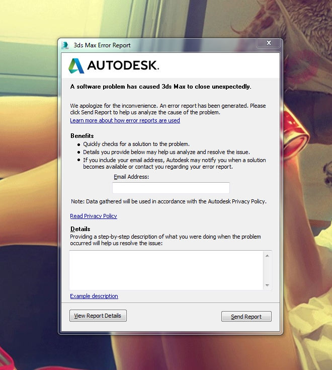

Elvissuperstar007 wrote:upsampling 4x4
Hi Elvissuperstar007,
it does not depend on Octane for 3dsMax plugin but on Nvidia support to windows 7.
In fact, no crashes or issue using windows 10 and Nvidia studio drivers.
I'm testing previous Nvidia drivers for windows 7 to find which one Nvidia drivers could be more stable with Octane.
Regards
