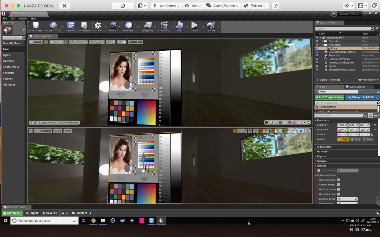

Hello Chris, Thanks for your fast answer!!.
1-When the ORBX imported, UE4 parent materials will be also created?
Do you mean if there will be a conversion step from Octane Materials to Unreal materials?
Yes, the conversión from ORBX to UE4 materials is the most important for us.
The idea is to create a set with Maya, 3DS, C4D.... with Octane, then export to ORBX, then import to UE4 so that we can Previs in realtime, and then record the camera tracking data in FBX format with our system so that we can render the whole movie with Octane Render with 10x GPU HPC Servers.
We've been successfull doing just the modeling and the UV (UDIM) with external 3D app, and then, light, map all the textures and create all the materials within UE4, rendering both at the same time Octane Render and UE4 so that both have the same color and same light.
We are using this system for feature films and fiction series. This is one of our first tests, https://vimeo.com/263196460
Best Regards

This is very impressive. I am going to try some tests similar to what you have done. I'm trying to understand your workflow in more detail and exactly what is supported or not. However I think the best way is to try it for myself then ask questions. Thank you for posting this. It is very informative.
One statement I don't understand. Why is the advantage of rendering in both Unreal and OctaneRender simultaneously? Is it for the match-move of the the actor? Are you just trying to get to a preview mode of what the lighting, etc in the final render will look like because?
