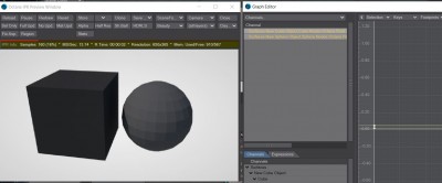

Sorry, can you share a scene to check this issue here? In a test scene, I can adjust two curves from different object surfaces and both objects are updated in the IPR, as you can see in the attached image.

Ok. Sorry, this seems a LightWave 2015.3 limitation. In LightWave 2019.1 you can adjust the two curves and the IPR is updated without problems, but not in LightWave 2015.3, that only updates one of them.
