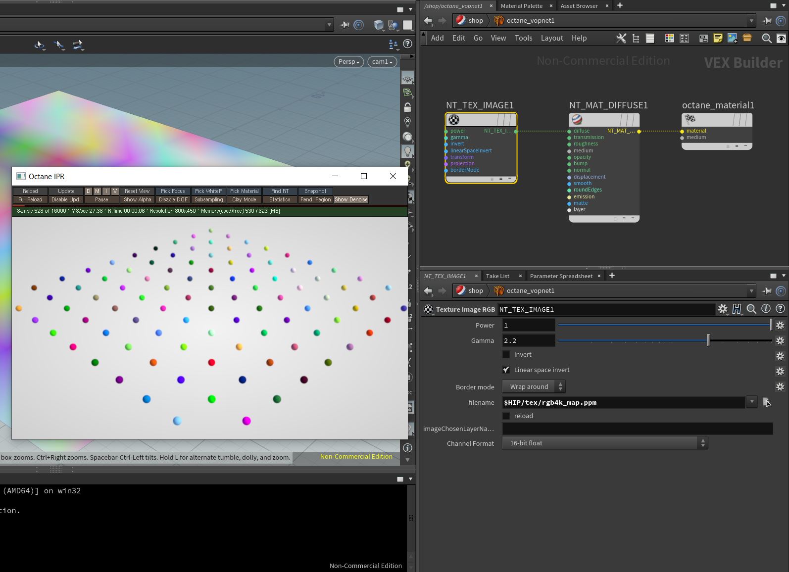

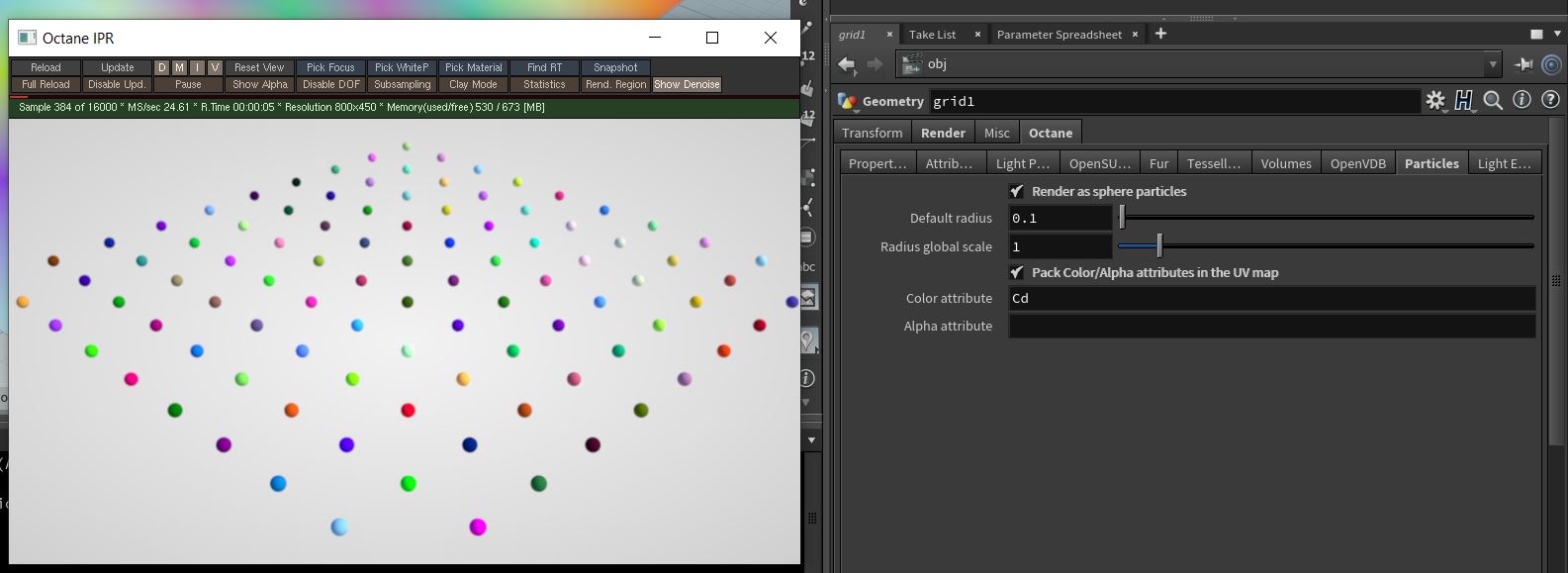

Attached you have a couple of test scenes including particles and instances colored from the Cd attribute using these .ppm textures. Octane doesn't support custom attributes in the instances or particles yet, so the Octane plugin is using a trick to support at least a Cd type texture packing the attribute inside the UV map, information that is decoded texturing the particles or instances with the .ppm files.

The instances still need this workaround to render the Cd attribute. The scenes should work, but please, check the texture path set in the texture node, probably your .ppm textures aren't located in this same path.

Hi Juanjo, the .ppm texture is the right path, it works fine when I render as particles. But when I try to use instances (via an instance attribute) it doesn't work. Has anything changed with the build that would effect the instancing workflow!?
juanjgon
Posts: 8867
Location: Spain
Weird! Here the scene attached previously in this topic works fine once you set the right path for the .ppm file. Are you sure that you are using the right texture from the plugin "tex" directory?
Thanks,
-Juanjo
Fantasy
Posts: 6
Joined: Sat Oct 15, 2016 12:19 am
Thanks for your reply Juanjo. I worked out what it was, I was using the wrong texture node in the shader.
