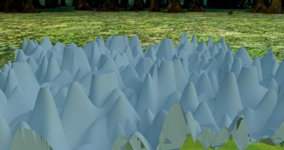

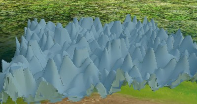

i recently noticed some holes in the geometry, which is created by the octane displacement. The holes are moslty visible on the faces, which are perpendicular to the eye and are greater the lower the resolution of the displacement map is. The wholes begin to disappear, when you turn up the resolition, (compare 256x256 and 1024x1024 on the example images), but they never go away completely. The example is a standard plane with an dents noise and 50cm displacement rendered with version V4.05 R5. The "steps" of the displacement are somehow not interpolating very well between the different values and it kind of looks like an "outline" at the edges of the bumps. I also tried it with Version 3.05, but the result is the same. Am i doing some fundamentally wrong or is this an octane related issue? This seems too me a very basic issue, but i couldnt find any comparable thread on the forum.

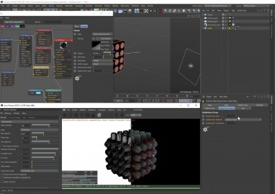

If I remember wall it is camera distance/position dependent, and the only solution is to subdivide the base mesh.
Please, give a try to ther new Vector displacement, if used with an Octane Object Tag/Subdivision, you can have the base mesh not subdivided in c4d, and have the correct subdivision, with corner control, only at render time, and It works with any kind of procedural node without baking: ciao Beppe
