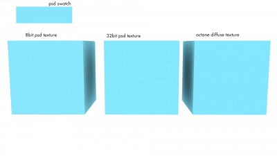

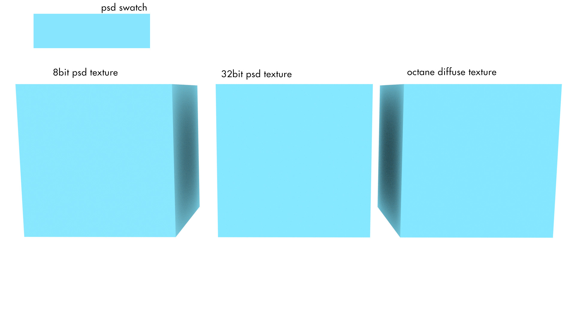

It looks like don't have a camera tag setup, do you have camera imager in your render settings?
I was able to render with a color match to the colors you specified.
Try rendering this and see if you get a match.
blue.zip
(191.83 KiB) Downloaded 193 times

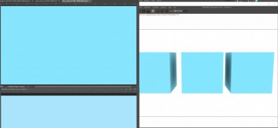

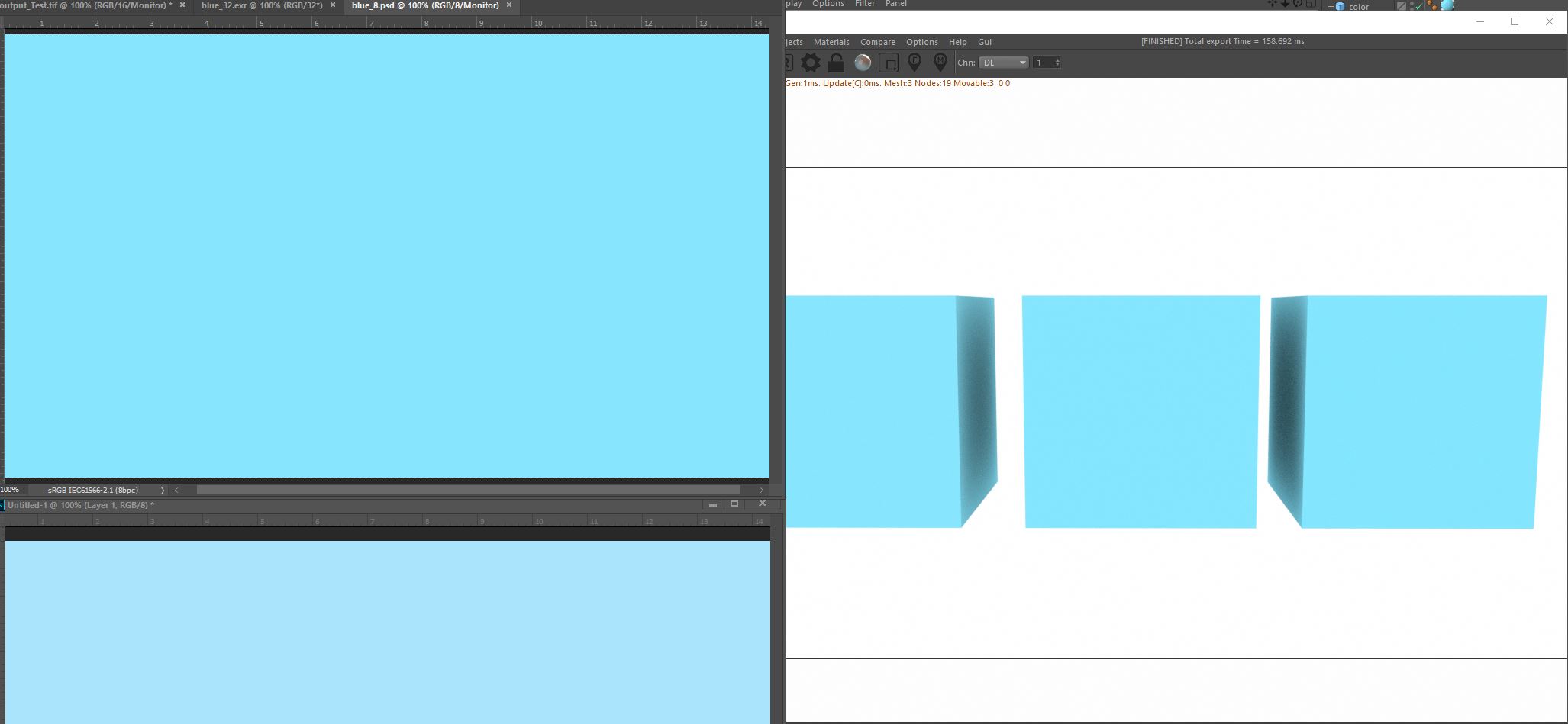

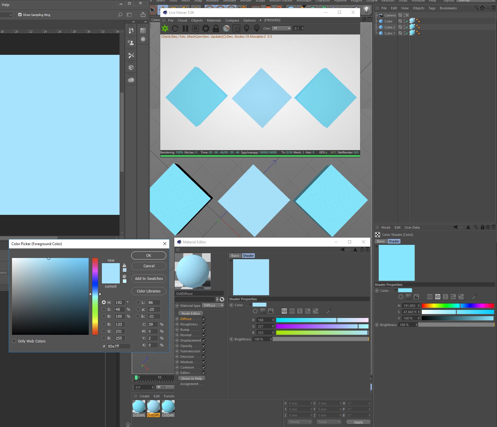

I've been looking into my photoshop setting and I noticed that selecting view/Proof Color makes a big difference in my colors matching my render result in the octane live view. Also when I render a result out of octane and it is converted back to sRGB space (with proof colors off) in photoshop it no longer matches the original swatch if both have Proof Colors turned off.
What does your photoshop work space look like?
Top left image is Proof Colors on, bottom left is Proof Colors off

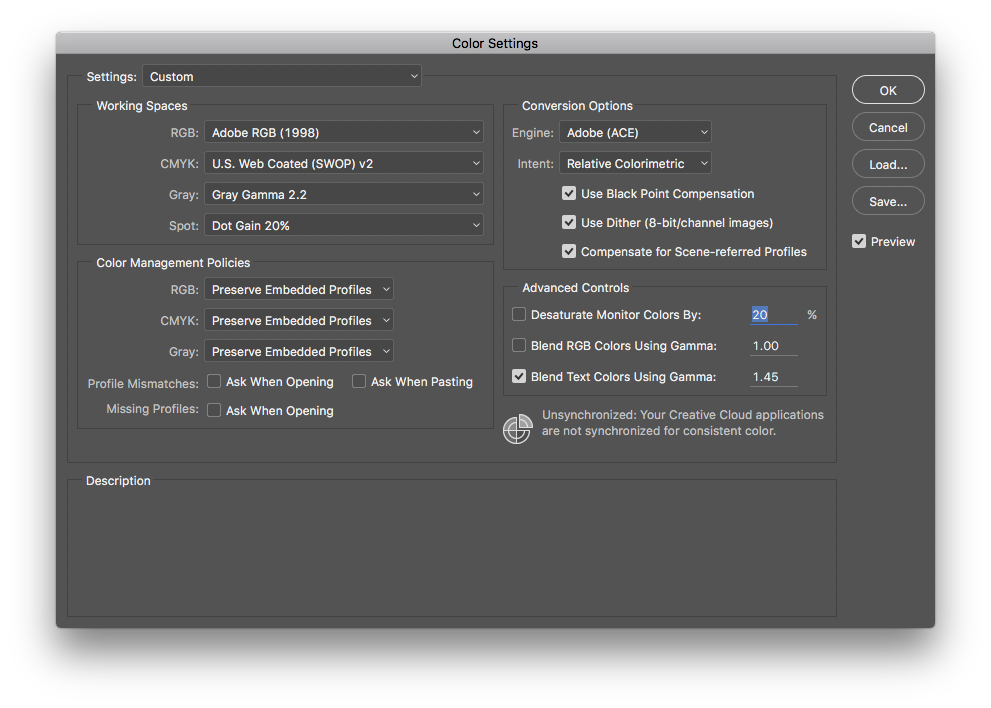

Is this what you wanted to see?
OSX 10.12.4 | Intel 12 core @ 3.33 ghz | 128 gb ram | NVIDIA GeForce GTX 1080TI | Ubuntu Linux slave with 3x 1080ti
Ibycus
Posts: 84
Joined: Wed Jul 08, 2015 9:52 pm
Thanks!
Yes, I was in sRGB working space for some reason. Been driving me crazy. Back in Adobe 1998 and everything seems to be working correctly now, hah.

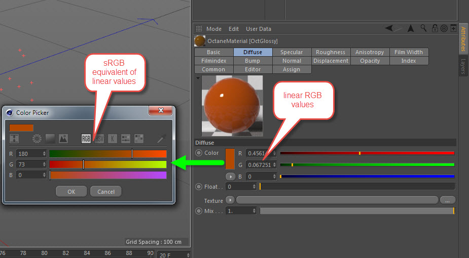

Just a note about color values in plugin.
young.r85
Posts: 21
Joined: Thu Sep 02, 2010 5:24 pm
Aoktar,
Can you explain the best practice method of using linear colors in Octane? Usually I grab a color from Photoshop and plug in the RGB values into C4D. Is there a better way to select colors in Photoshop using a linear mode? I don’t know what the typical Octane sliders for RGB correspond to. I always go into the color and pick it from there. I rarely pick colors using Octane’s sliders.
Thanks! Any advice that may help color accuracy is appreciated.
