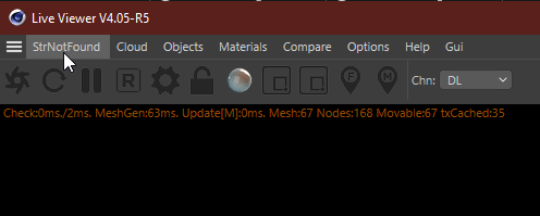

*LV shows "StrNotFound"pm the top menu (image attached)

The LV window showing "StrNotFound" seems to be related to Maxon as it is showing up on the content browser as well so not to worry about that.
