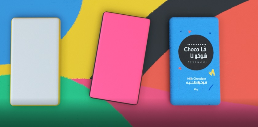

Notice how the second and third chocolate bars don't have their respective textures on them:
They are both duplicated object animations from the Blue chocolate and i just replaced their textures and their end position.
On the other hand, when i render a still frame of the video as one image, they do appear each correctly:
I've added an "Octane Object Tag" on both textures, they're still not showing in the video rendering. What could be causing this, any idea?

There should not be any difference if you use DEFAULT values in render settings. Other than this nobody can answer it without knowing your setup

There seems to be a glitch in Octane finding the textures after long periods of rendering, otherwise i can't tell what is causing this. It doesn't seem to make sense.
I rendered the video a second time STARTING with the Yellow frames and reaching the end, the Yellow one appeared but the Pink one didn't appear:
https://youtu.be/lL3Eh-dxAh8
Then i rendered the frames STARTING with the Pink one and it seems to have worked for that last part alone as well:
https://youtu.be/POHvBljtqDs
A little note: When i press on Octane's icon in the Live Viewer it loads the textures correctly, but before pressing that icon sometimes it wasn't appearing as well in the Live Viewer.
At this point i think i'm gonna merge the 3 videos on After Effects, but i have no idea what is the problem?

Be sure there's not a name conflict and using ImageTexture
