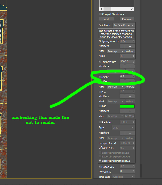

it seems that if i dont get a message optimizing volumetric octane wont render and it has nothing to do with conservation type
UPDATE:
it looks like unchecking SMOKE made octane not to render volumes. Not sure why. It is an old bug.

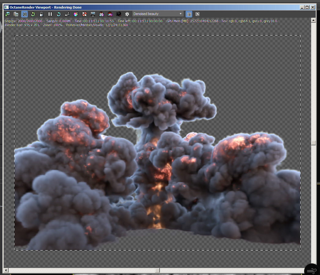

Hi Paride,
were you able to reproduce the problem where octane renders when it wants to. Sometimes it just wont render until max is restarted.
If you have 2 volumes and isolate one and render the other and then exit isolation mode, open octane viewport and try to render you might see no volumes in the octane viewport.
usually max 2020.2 must be restarted
you can see in the image no wagon and two fires are missing. I am not sure how to trace the bug so you can reproduce it.
