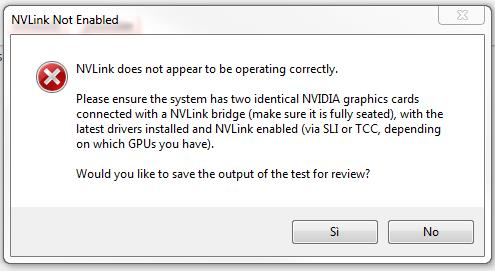

Could perhaps someone give me some suggestions? I've tried in these days to enable NVlikn but without success.
1) I've bought an AORUS NVLINK™ BRIDGE (3-slot) for my 2xRTX 2080ti Gigabyte
2) I'm on Windows 7, Cinema4d R18, Octante 2018_1_3, Nvidia driver 419.7 and 436.30 tested
3) **** My MB is an old ASRock Z97 extreme9, with an i7-4790 that drive only 16 lanes
4)*** I have 3 gpu in all, so I suppose that the total lanes available are divided as 4-4-8
5) I have enabled SLI mode and double checked that NVlink bridge are correclty inserted on the cards
6) Running NVlink test give always the same error Could be related to my too old MB or by a wrong PCI slot configuration?

Giolets, do you have monitor plugged into one of NVLink cads ?
Architectural Visualizations http://www.archviz-4d.studio
I have connected one monitor to one of my Nvlink cards, only in order to allow windows to enable SLI features. Then I've re-connected all my three monitors to other card (not-vlink card, used only for display).
In any case I've run the test in both cable set configuration...
