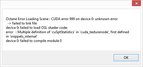

So we uninstalled 2019 and installed 4.01.1.57.VR but we get the following error.
O4R - 4.01.1.57.VR error.png (6.79 KiB) Viewed 19219 times
Older version of Octane will not work with the latest Nvidia drivers, and give the Octane Log errors you got.
