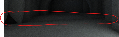

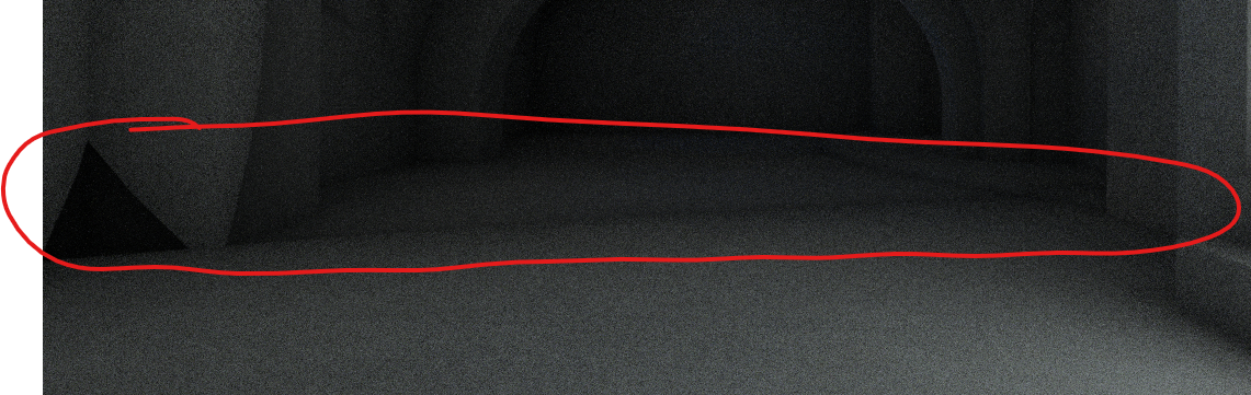

This is what spectron light is doing. A visible edge of a light cone.
Spectron light cone is affecting Octane dirt texture ! It should be invisible to dirt texture.

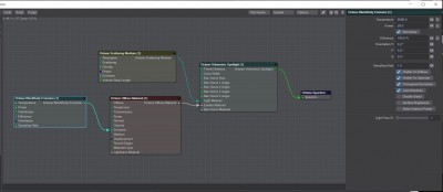

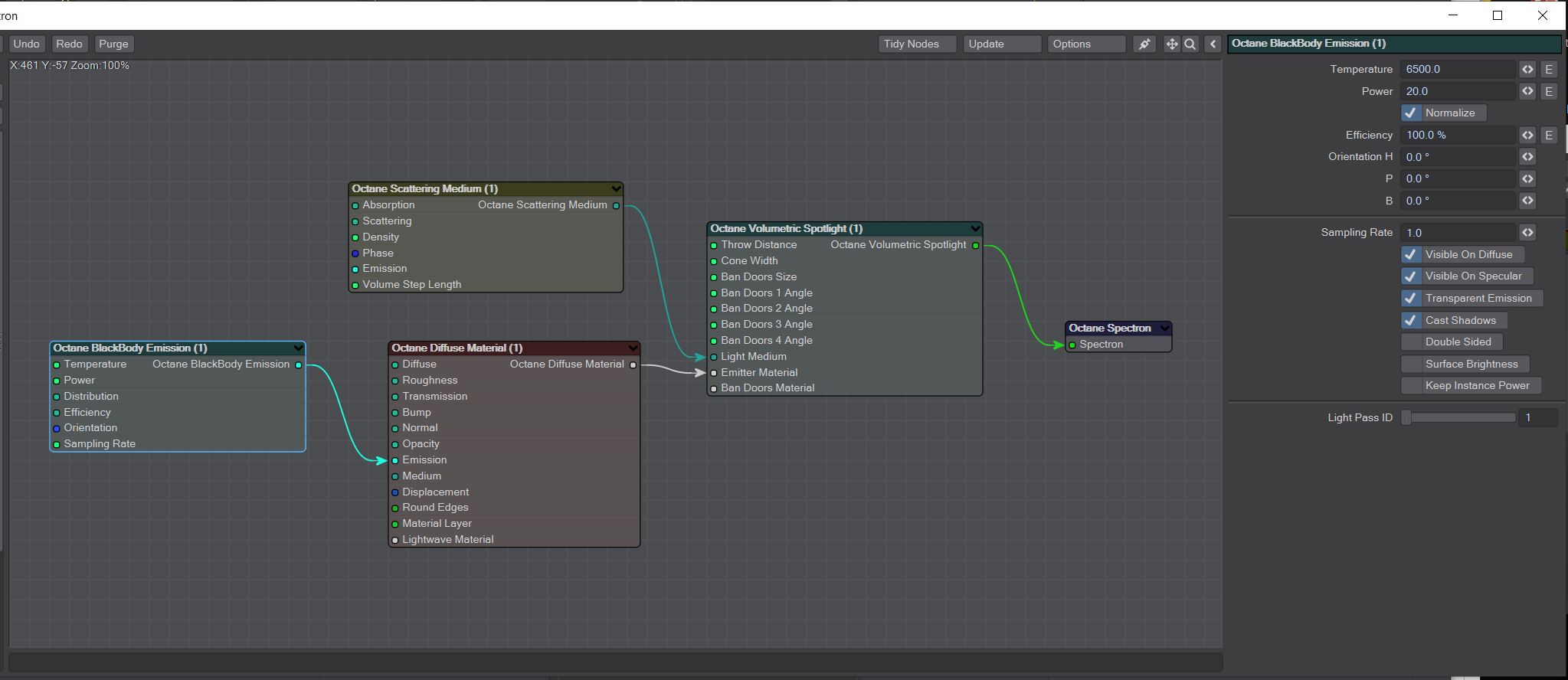

BorisGoreta wrote:Spectron is bugged too.
How do we control color or intensity of spectron light ?
You can link an emissive material to the Emitter Material input to control any parameter related to the light emission.
Thanks,
-Juanjo
