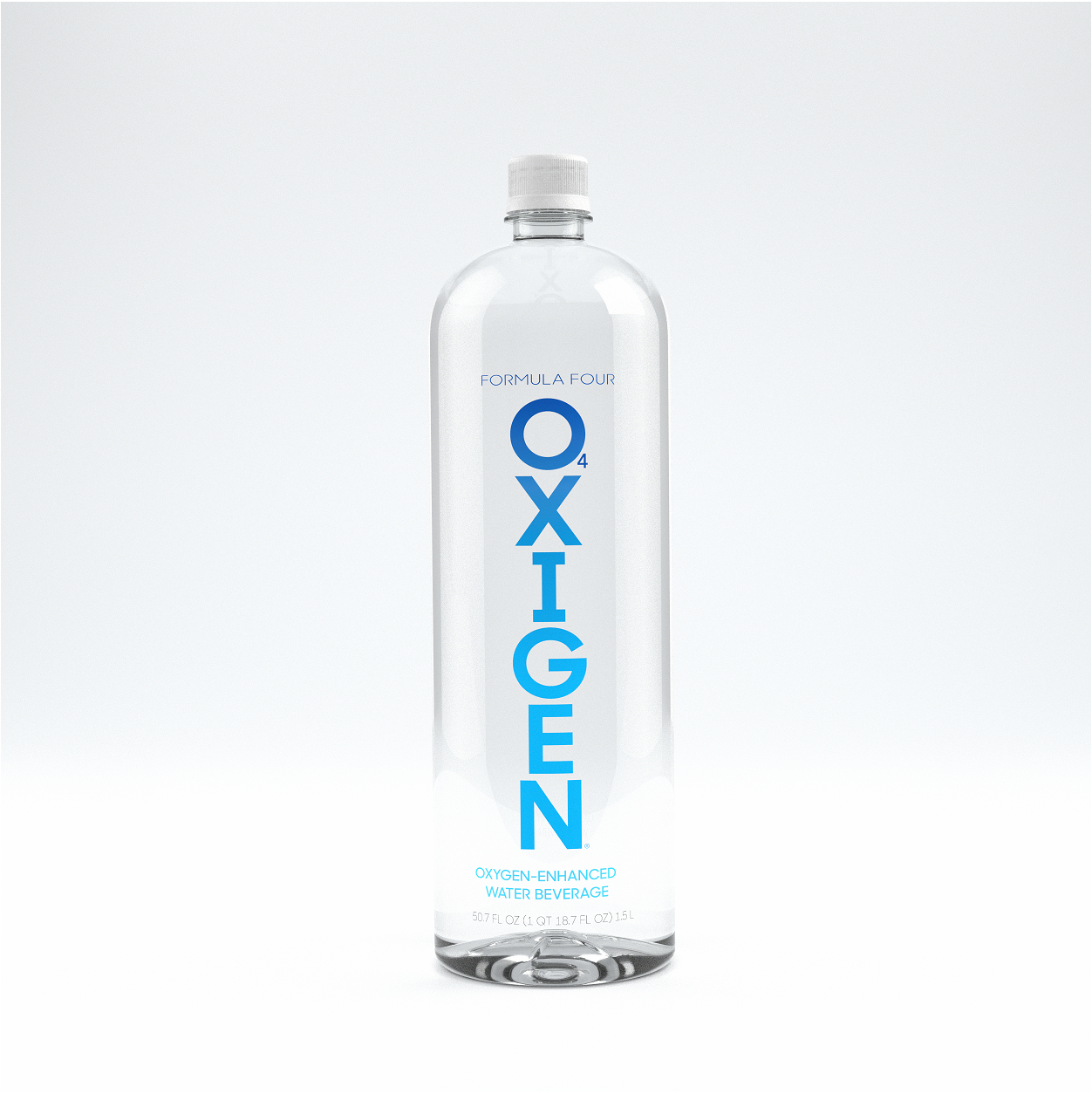

would someone be so kind as to help me understand how to set up a basic gradient ramp in the opacity channel of an emissions texture node so i can get the effect in this image. i want to be able to control the falloff direction easily and adjust the brightness of the emmissive texture on a reflector card for a product shot...as shown in the modo preview with the bright reflector card in the image.
i appreciate any help in understanding the proper node flow. thanks,

and even more cool would be the ability to control a gradient ramp in both the U and V directions (horizontal and vertical)...probably two gradients need to connect with a mix node or layer node somehow in that case?

Hey Rod,
Here's one way you can do it. "Octane Gradient 2 U" controls the gradient on U, while "Octane Gradient 2 V" controls the V gradient. They are both multiplied into a single texture.
This example plugs the combined gradients into the material's opacity (since you asked for it), but I generally plug my texture into the emission node texture input.
The zip includes an lxo and orbx (for anyone who doesn't use modo)

wow Funk, you're such a gentleman. this is the second time i've run into your helpful input in the past couple days. your node setup looks perfect and i wouldn't have figured it out with all the non-intuitive node process. it'll take some time with tutorials. this is very useful though. your suggestion to plug the output of gradients into the emission node should also work. i've just found in the past that fading to transparent gives added safety on reflective surfaces so that the dark color isn't getting reflected and causing an edge to show. if you place things right you shouldn't see that in this particular case.

by the way, here is a raw render of the product shot i was using your texture setup on. fruits of your labor, if you will:
