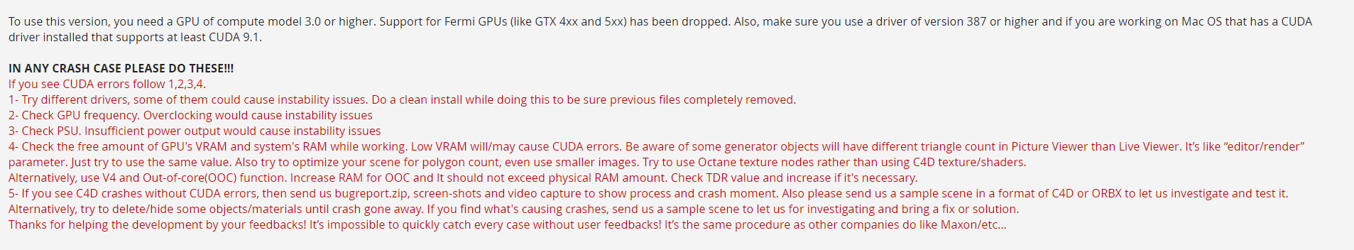

1-Try this driver
2-Try just with one gpu
and read this
Btw email to otoy support if you can't solve that. I'm not support, just developer.

aoktar wrote:1-Try this driver
and read this
Thank you aoktar this information is very helpful! I don't want to count my graces just yet, but I may have found the solution. I think the problem was due to overclocking the GPUs via the MSI Afterburner app. When I reset the clock speeds to their defaults, I have not had any crashes while rendering one particularly intensive scene which was crashing before after only a few frames.

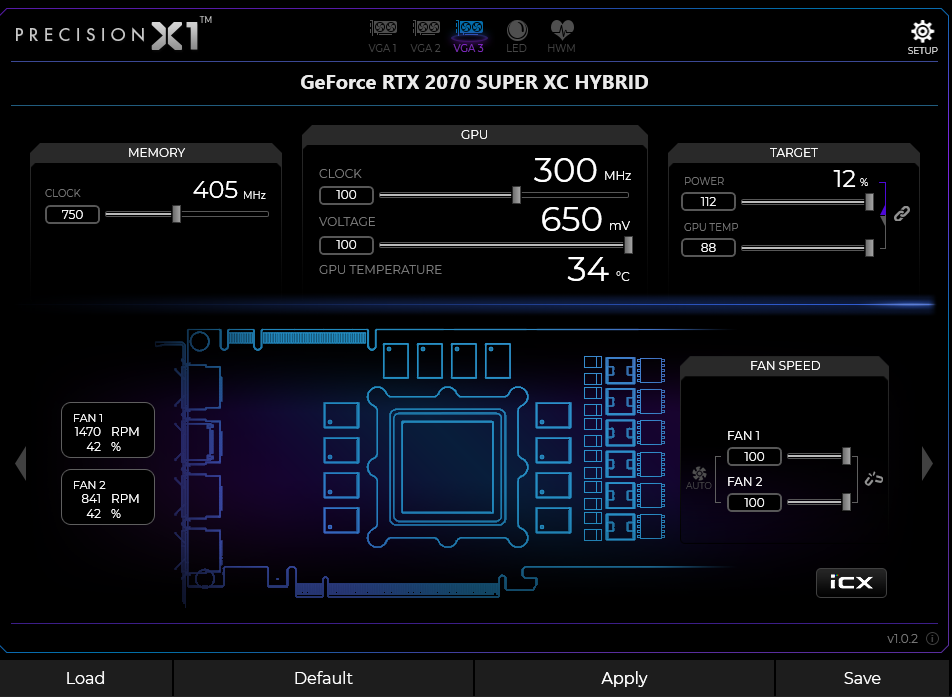

I'd like to chime in on this as your answer has solidified my thoughts. I have a similar build. 2x 2070 supers (literally got installed yesterday) and 1 1080ti (have always had). I had always OC'd my single 1080ti prior to getting the 2070 supers, assuming that regardless, at some level it has to be better than not OC'ing. I never had even one issue OC'ing the 1080ti and rendering via the queue or any other means. That being said I have noticed this issue in full affect since I installed and OC'd the two additional 2070s (only running those two cards with the 1080ti disabled in octane) with my renders being specifically vectron but I have the feeling this would happen with any content such as you explained in your OP.
After reading your post I realized that the one time got my render queue to successfully go through 3 different renders (385 frames each), I had also forgotten to enable my OC, meaning that the issue, for some reason, probably has to do with the OC directly.
Furthermore when I was testing my OC initially with Octane, even though my OC worked fine in games and other benchmarks with flying colors, If I tried to render something with a high OC in the live viewer, it would immediately go to a render failure. I then tried to slowly lower the clock till I could get octane to work which I did with the below settings, only to later realize this is more than likely the cause of the issue with the render queue.
I will be running some renders tonight to test out this theory.
Hope this thread helps somebody else :)
Current OC settings that force close render queue after about 500 frames
