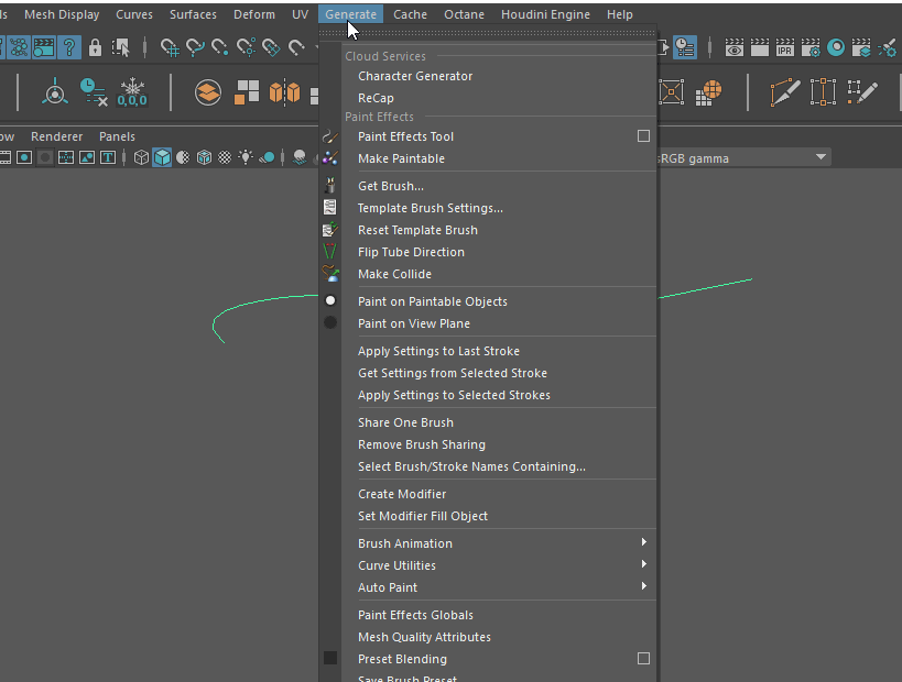

It is not possible to render particle primitive directly with the Maya plugin , you have to use the instancer, and pay the vram price for that.
viewtopic.php?f=28&t=53832&p=272443&hilit=curve#p272443
It is not possible to render curves primitives directly with the Maya plugin, you have to convert them to paint fx first.
