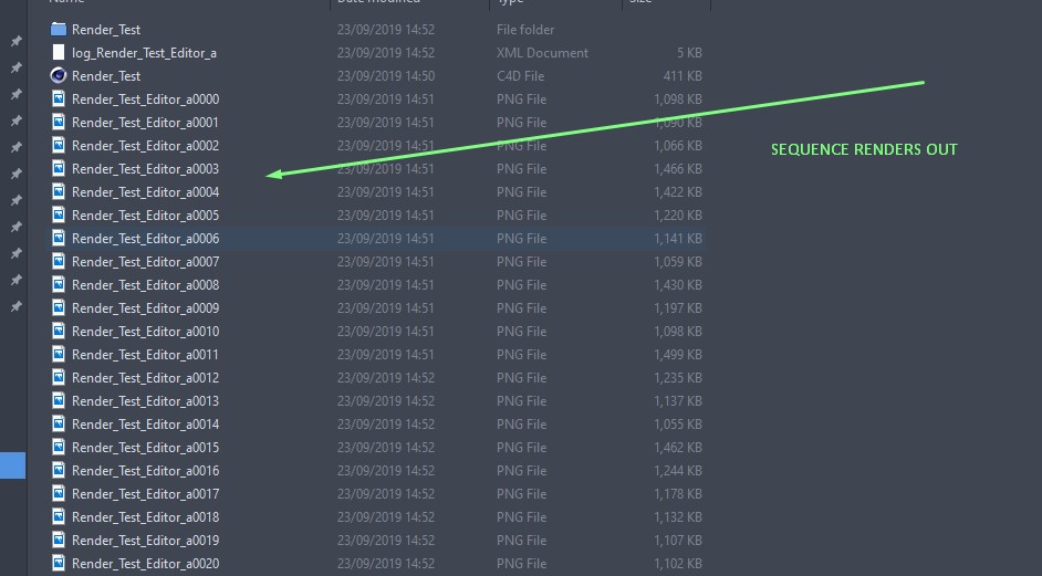

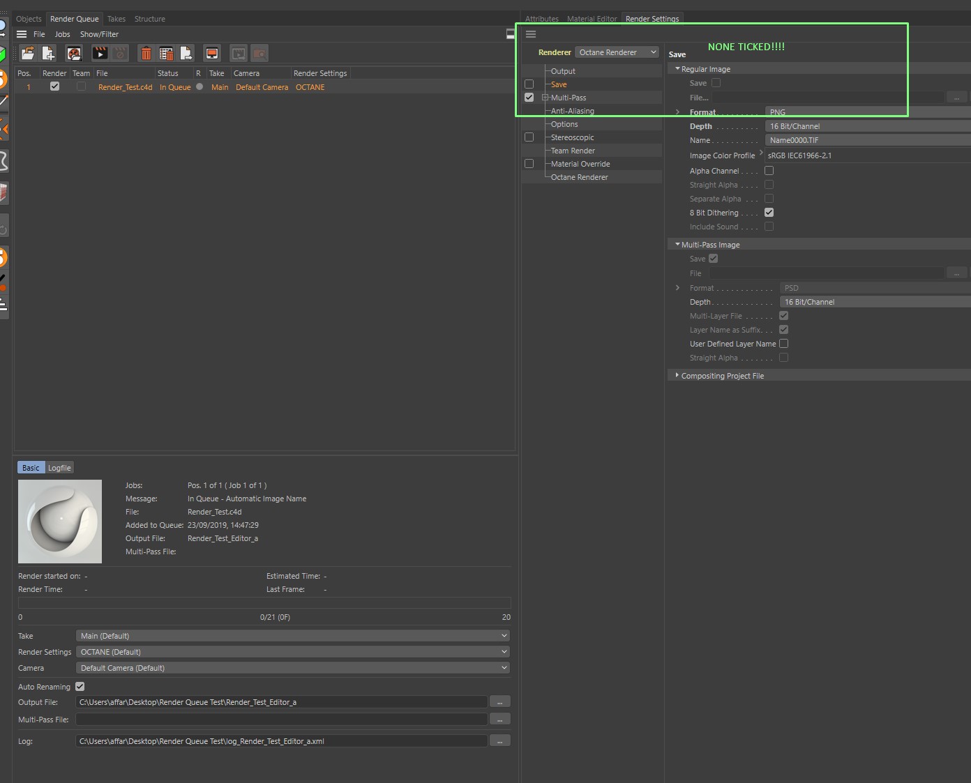

When I add scene via Render Queue it still renders out to project folder even if I untick the standard save... creating an additional render sequence and leaving things very messy...
If I do this to picture viewer it doesn't do it, so seems to be a render queue problem? Is this something that can be fixed octane side?
I''ve attached a C4D file which renders out to to a folder in the same directory...If you try rendering via picture viewer and also with render queue then look in the folder where the C4D file is and you can see a residual render that's produced even though the standard save function is turned off :(
It's not a HUGE issue but it's very annoying when your compositing and working and you have a folder filling up with images you don't need, plus the time it adds onto have to write an additional image file.

Sorry but have you tried with Standard renderer? Probably not because it's happening with that too, because it's not a BUG or UP to Octane.

aoktar wrote:Sorry but have you tried with Standard renderer? Probably not because it's happening with that too, because it's not a BUG or UP to Octane.
Havn't used standard renderer in years so I was unaware, I wasn't insinuating that it was just Octane I just wondered why it was happening as it's been bugging me during a few projects now...
At least I know it's not just Octane now,
Thanks.
