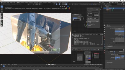

The best way to get camera mapping right now is to use an OSL shader. You can "copy" the scripts from here:
viewtopic.php?f=21&t=65575
This one can be used in an OSL projection node, it works great:
shader CameraMap_geo(
output point uvw = 0)
vector p = transform("camera", P);
float fov;
int res[2];
getattribute("camera:fov", fov);
getattribute("camera:resolution", res);
uvw[0] = 0.5 - 0.5 * p[0] / p[2] / tan(fov / 2) ;
uvw[1] = 0.5 - 0.5 * p[1] / p[2] / tan(fov / 2) * res[0] / res[1];
I hope this helps.
