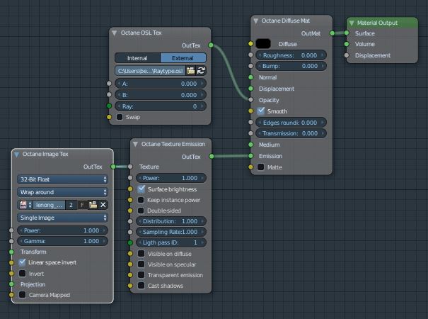

Chris - I couldn't get this to work, but solved it with the Raytype OSL with some pointers from a MODO thread. Setup looks like this:
...no idea what it's doing, but it works.
I'm still interested in your version, though...

I think I misread your question the first time.
You can see what I meant in my first answer see the attached screen shot.
If you just want it as a backdrop you can try to disable "Shadow Visibility" on the Sphere in the Object Data settings (This should work fine with opacity at 1 etc):
Then it won't obstruct the environment light. But NB: When you do this the "environment" (like the sky) won't be visible in reflections, but the light (the sun) will be.
If you want to have the HDRi visible in the reflections and refraction you have to have "Visible on Specular" enabled on the Emission node.
