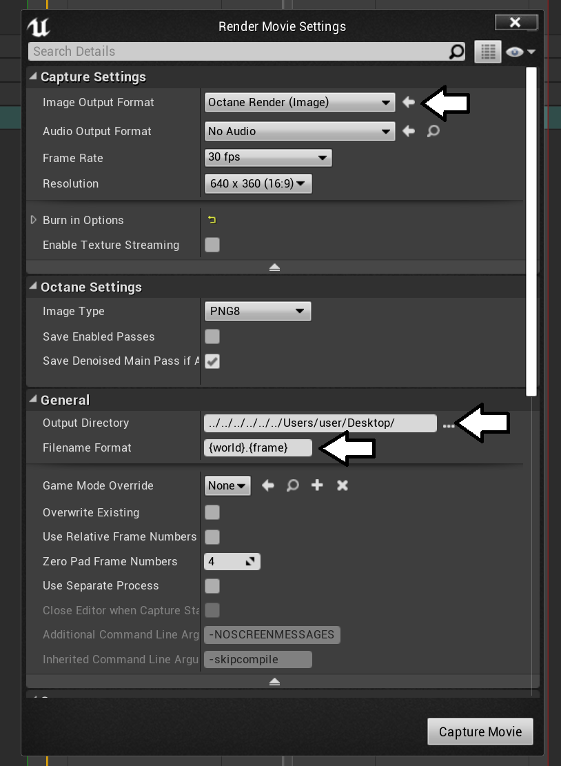

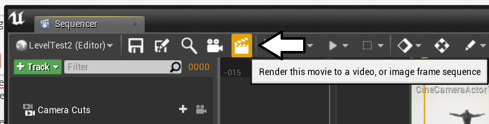

- Turn on Octane for Unreal
- Open your scene that contains your sequencer animation
- Create or Select a Rendertarget and press Render
- Open the sequencer animation you want to render
- Press the following button:
In the popup window make sure the following are set:
- Image Output Format is set to Octane Render (Image) or Octane Integrated (Image)
- Output Directory is set to where you want
- Filename Format contains {frame} in it. Otherwise it will override previous renders.
- Press "Capture Movie"
If this dosnt work, could you send over your scene and the steps you are taking?
I have every single sequencer project I could get my hands on for testing, and I created test scene that features everything that we want to support. But it might be that there is something that we missed.
