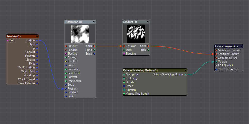

Here's the node setup for the volume object (the item info is getting position of a moving null I've put in the scene)
