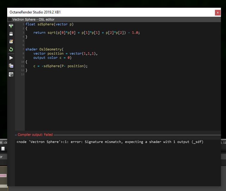

<node 'Vectron Sphere'>:1: error: Signature mismatch, expecting a shader with 1 output (_sdf)
I'm getting this error in every single vectron example.
I'm not a coder so I don't know what exactly is the issue.
regards
Rohan

The shader should have an _sdf (signed distance function) output instead of a color.
Add this line at the top:
Code: Select all
#include <octane-oslintrin.h>
The output argument can be declared and initialized with this:
Code: Select all
output _sdf out = _SDFDEF
and in the code you need to assign the result to the .dist member:
Code: Select all
out.dist = - sdSphere(P - position);
Check the code of the default Vectron sphere for a simpler version.
