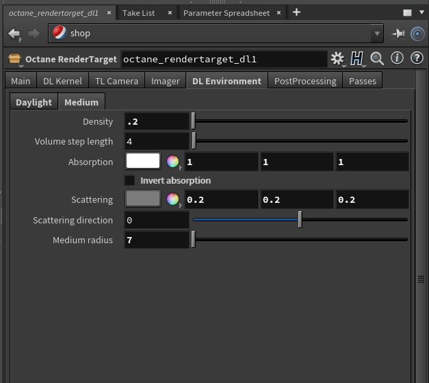

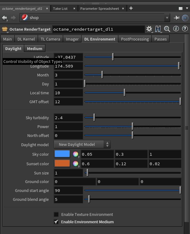

hello Juanjo
Please tell me how can i render the fog effect with octane . i can't find it .
thanks,
-hubble
juanjgon
Posts: 8867
Location: Spain
You can enable the environment medium option in the render target environments and configure the medium in the "Medium" tab.
Thanks,
-Juanjo

Thank you Juanjo!
i see
