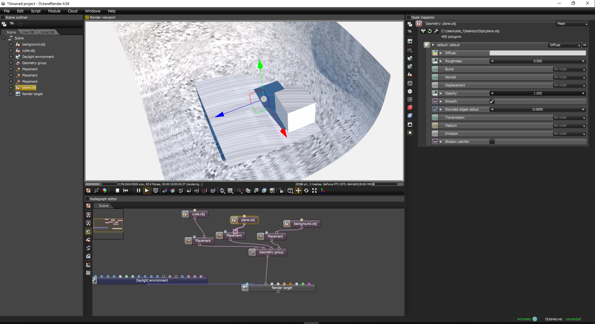

So every time I import a mesh into Octane it has these weird textures, even if it is flat like a cube or plane. Tried with different cameras, or materials, but that weird texture is always there. I attached a screen shot.

Read ray_epsilon from manual and increase it for solution.
I hope you read "ray epsilon" what does.Edember wrote:Wow, okay, that solved the issue. It is just so weird, this stand alone, I can also barely navigate in it. But thanks for the answer!
