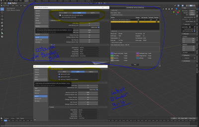

I have two GTX 1070 cards in my system both perfectly working and recognized in the official Blender release in the preferences.
When i run the Octane for Blender version none are recognized even though I activate them in the preferences of Octane.
The issue is as shown in the picture that my second card Octane preferences window wouldn´t allow me to select it to activate it, so there must be something going on with this version because the official Blender release is able to recognize both cards.
Any ideas?
Any ideas?

Hi, the free version is limited to one card.jonbragado wrote:Hi,

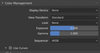

aFQRSSD wrote:Do you guys know how to get rid of cliped values ? Using the filmic option in color managment doesn't seem to work, it just makes the image darker or lighter without revealing cliped values.
Try setting the Display Device to None in the Color Management, Octane has it's own Color Management.

The CUDA support for Cycles has been removed in this build (including some other Cycles/Eeevee features), that's why you don't see the GPUs in the Settings (it does not reflect the Octane support/settings)jonbragado wrote:Hi,
Any ideas?
