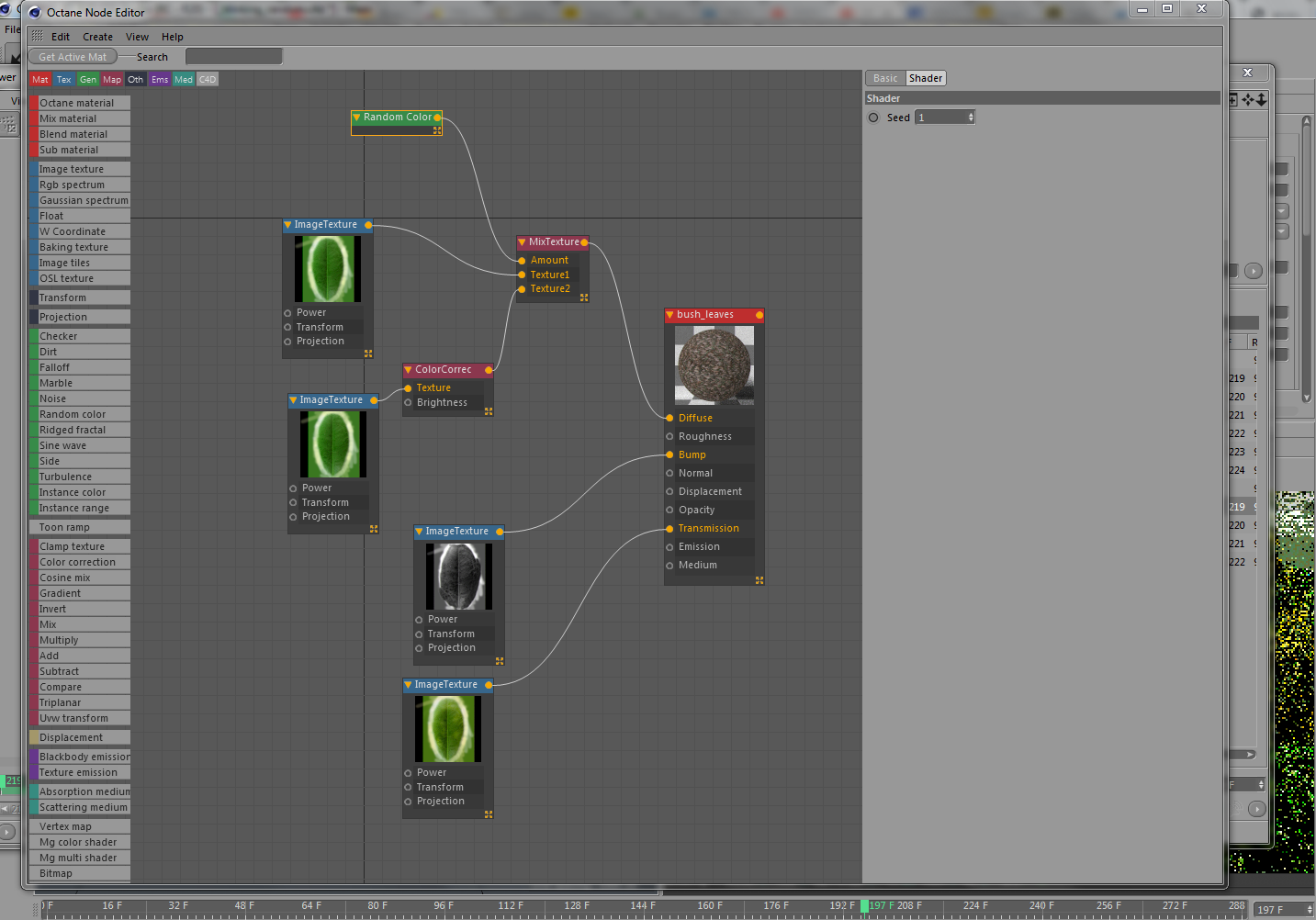

Hello! Need help :(
Can't figure it out how to use Random Color node (Cloner objects driven with Plain effector) to get FIXED and NOT blinking color variety.
No parameter in Octane material is animated, but using Plane Effector that has moving Fields, gives a blinking random color.
Disabling the moving fields gives fixed colors under Random Color node.
Got the right result hundred times, but now frustrated....
Please help, who knows the right settings for that trivial task?
Thank you in advance
Octane 2018-2019 no matter, Cinema 4D R20.059
video, screenshot and the scene are attached
