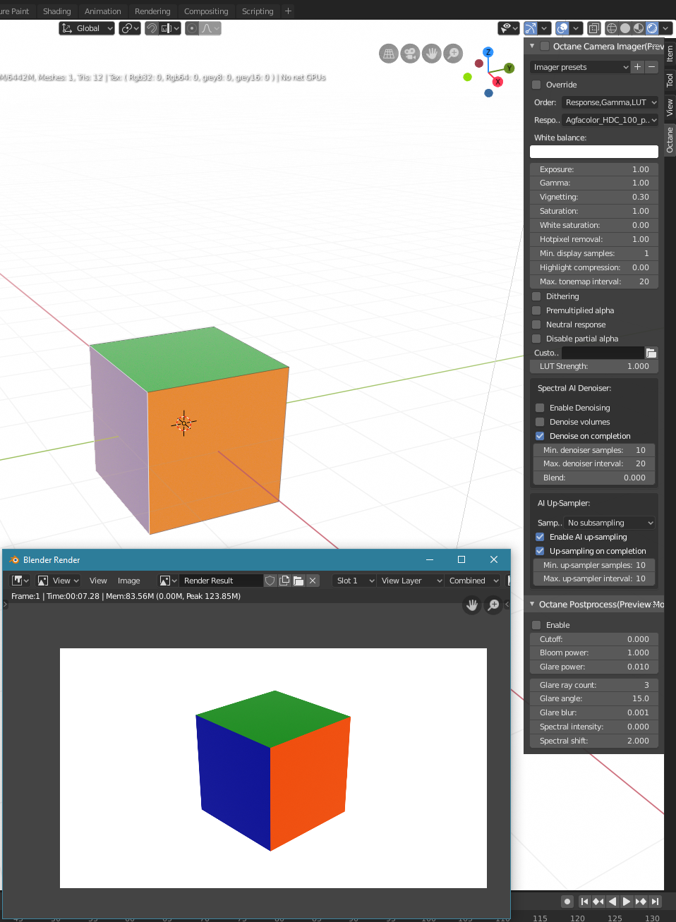

I understand in order to have the final render match the live preview that the OctaneImager has to me checked on for the render. Is it possible to show a non-tonemapped image in the live render window? Basically having the live viewer match the output of the final render with the OctaneImager set to off for final render.

jerzy wrote:I understand in order to have the final render match the live preview that the OctaneImager has to me checked on for the render. Is it possible to show a non-tonemapped image in the live render window? Basically having the live viewer match the output of the final render with the OctaneImager set to off for final render.
1. To match the live render view and final render you need to disable Blender's color management by going to "Color management" settings and set the "Display device" to "none" Im assuming that Octane Imager is turned On .
2. If you want to show non-tonemapped image in the live render window you need to disable Octane imager and disable Blenders color management. Unfortunatelly this is buggy and final render is not the same as in live view.

I had the Color Management set properly and the Octane Imager was disabled but I wasn't getting the same results as 2.79 / V4 so figured it may have been a different procedure for 2.80 / V2019. It is an early beta so I just have to be patient.

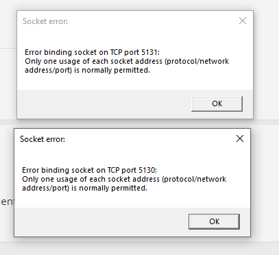

I launched the OctaneServer.exe and got some errors. See screen capture. Any ideas what this is?
So, is this only limited to 1 GPU. On the machine I'm testing it on, I have two 780ti but only one can be checked.
Also, how do you use an hdr image for the environment?
Thanks for the help in advance.
BK
Posts: 1475
VISUAL360 wrote:I launched the OctaneServer.exe and got some errors. See screen capture. Any ideas what this is?
Hi there,
You are likely trying to run multiple instances of OctaneServer.exe at the same time, please check the taskbar for an Octane logo.

If you use Octane Imager settings from 3d view and want the same settings in final render make sure the "Override" option is enabled.
