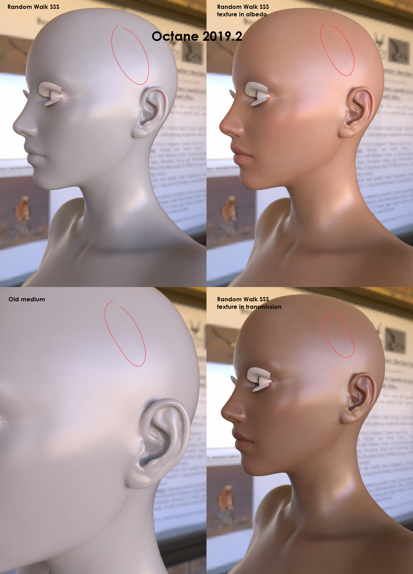

There is an issue with the new SSS. With Daz models the skin is broken into multiple sections, Face, Torso, Arms and legs. So you need different shaders for each section to setup the full skin.
In 2019.2 I can see a visible seam between the two shaders. This wasn't happening before.
I'm attaching a very simple orbx to demonstrate the issue.
regards
Rohan
