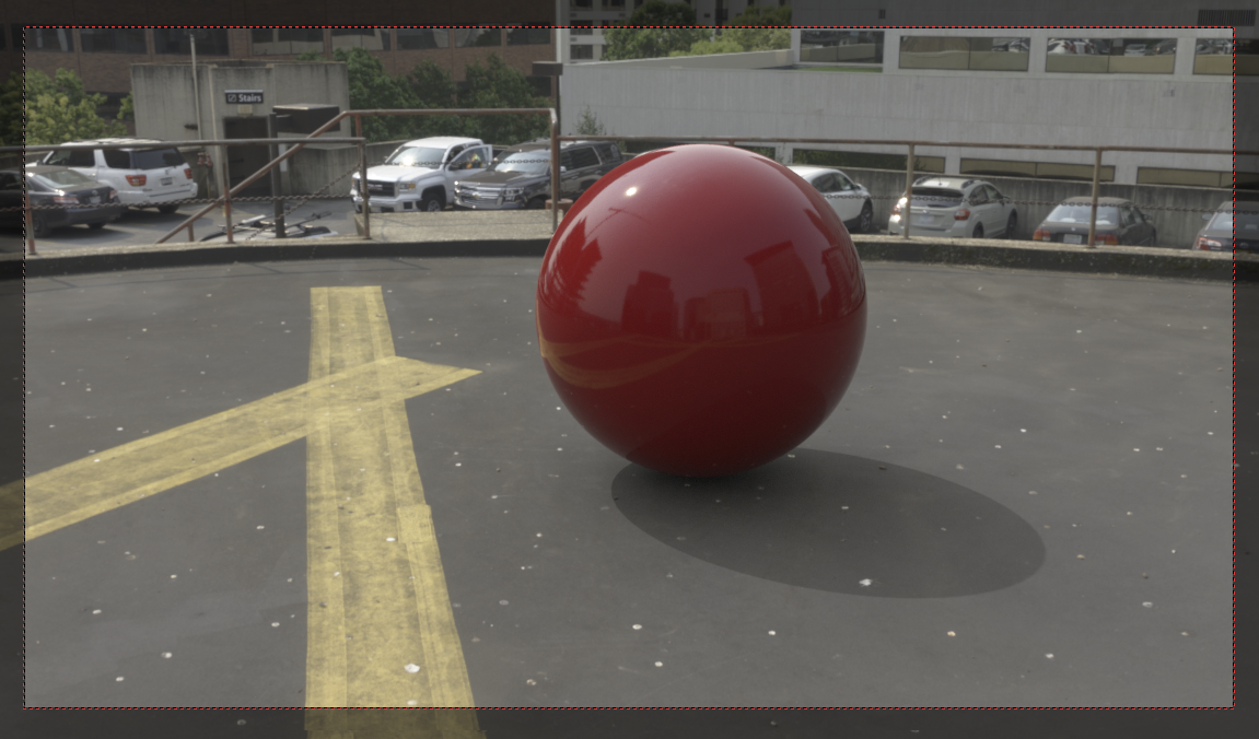

I think I have another obvious one that I am not getting: Shadow catcher.
With a sphere as my object on a plane, I should be able to simply use a Universal Material with Shadow Catcher ticked in order to create catch shadows within the preview and the render, yes?
I am looking at an HDRI scene that provides the floor imagery. Not seeing any shadows with my shadow catcher plane. When I lift the shadow catcher plane, it makes the object disappear, as if it were a boolean operation. (could be handy, I suppose)
Any help appreciated,
Rick

Hi Rick!
Try to flip the normals of your plane (or turn it around 180 degrees on X/Y), i think that might be your problem.

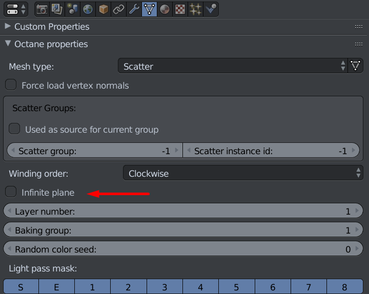

(Also, side tip: You can enable "Infinite plane" to have a "ground" with no edge)

but, where is this infinite plane enablement thou speakest of????
Haha! Thank you, I think.. Maybe I should add that to my signature‽ :D
The infinity plane option is in the "Mesh panel", under "Octane properties".

Another one hiding in plain sight....
Thanks again, J.C.!
