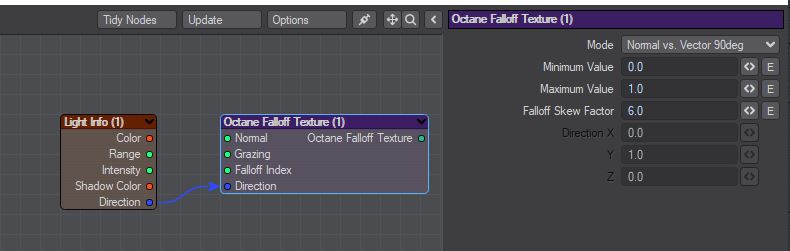

You could try to use the light info node direction output to see if it helps ...
Thanks,
-Juanjo

I was under the (apparently mistaken) impression that using non-Octane nodes was verboten. Would it be correct to say that this only applies to LightWave materials, but the other nodes (e.g., the Light Info node you just pointed out) are fair game? If so, this opens up all kinds of interesting possibilities. Will do some tinkering and report my results. Thanks!

Well, after fiddling with it for an hour or two I still couldn’t figure it out, so I’m just going to fake it by enveloping the specular color changes. Thanks anyway...
