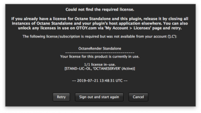

License error when launching server v18.2

Hello J.C,
Thanks for your report and sorry for the inconvenience.
Please make sure whether it's compatible with the license you hold.
You should be able to find the enterprise builds here.
https://render.otoy.com/account/downloa ... erprise%5D
The studio builds here.
https://render.otoy.com/account/downloa ... RC2+-+18.2
And, the regular here.
https://render.otoy.com/account/downloa ... Regular%5D
Cheers,
DrawFun
Please notice that we have updated the release post and now the links are for enterprise license holders (the same as before in 17.x and 18.x).The download links, provided on the 18.2 release thread, are for regular license holders.

Hi DrawFun, thanks for the information. Enterprise version worked for me.
So [Enterprise] version is for OctaneRender 4™ Enterprise DCC / All-Access Bundle license
and regular license version is for Unbundled OctaneRender 4™ Enterprise DCC Plug-ins license?

Regular = OctaneRender 4 Enterprise DCC Combo. It will never expire.J.C wrote:Hi DrawFun, thanks for the information. Enterprise version worked for me.
And, OctaneRender 4™ Enterprise DCC / All-Access Bundle license = Octane V4 (regular) + OctaneRender Enterprise All-Access Annual Pass (12-24 months ), limited time to access octane 2018 and 2019. But once the 2018 or 2019 expires 12-24 months then your license will be reverted to V4.
For more details, please refer to https://home.otoy.com/render/octane-render/purchase/
