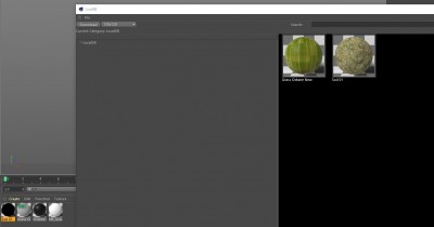

I’ve saved my textures into the LocalDB but when I download them into a scene the textures are missing. Reload or locate doesn’t work. I haven’t move the texture files either.
Thought it might be because one of them is a forester texture so tried with a RDT texture & the same problem.
I’m using offline dongle so not sure if that’s causing an issues ?
Maybe I’m missing some thing obvious ?

Plugin cannot find where do you download the textures if you download these before the saving of scene.

Ok,
I've saved the project with assets.
Dragged the materials I want into LocalDB.
Saved scene & closed.
Opened new scene, downloaded Material from LocalDB & still no textures ?

OK, Solved.
Need to save the new scene before using LocalDB textures.
