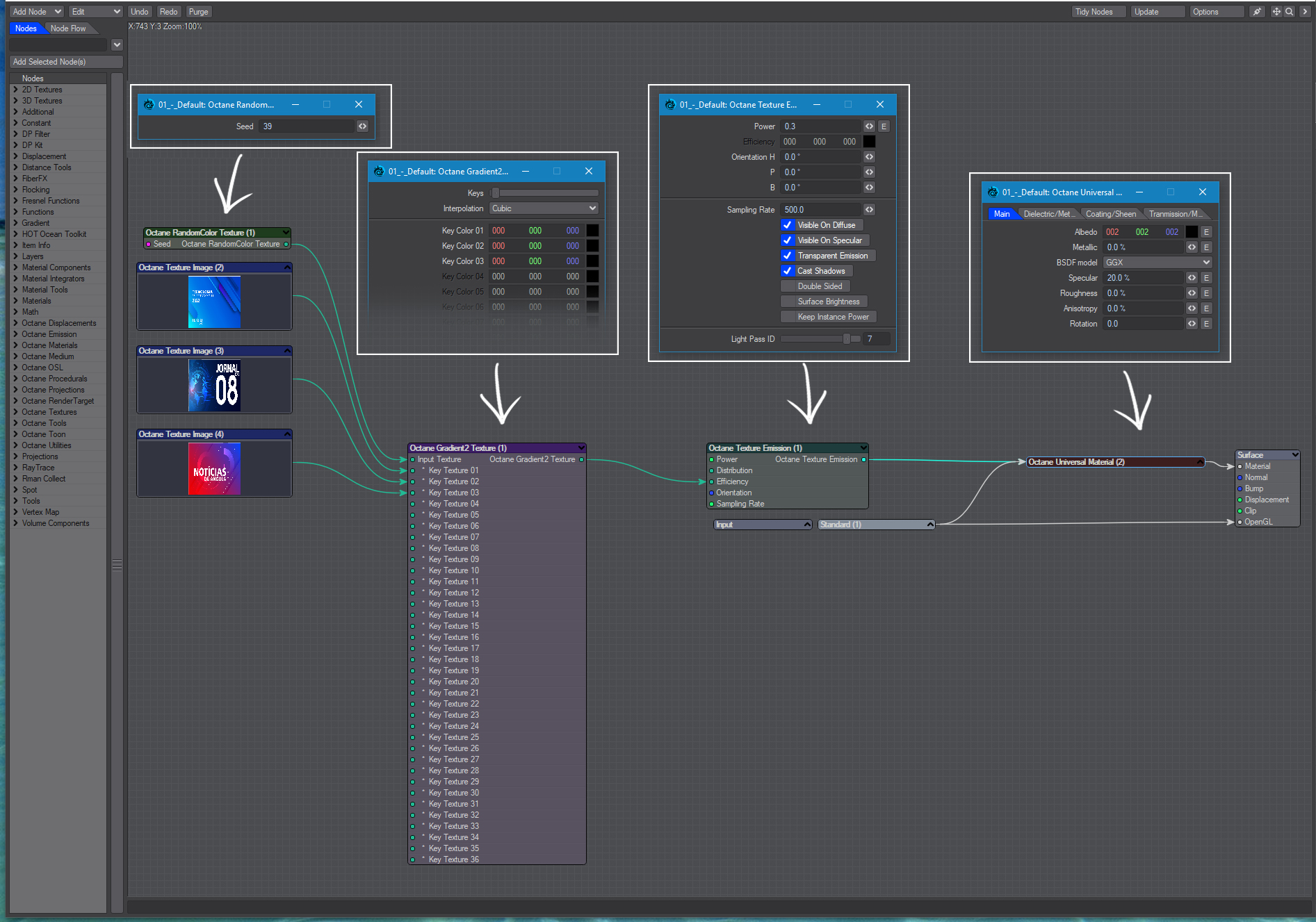

Hi Juanjo.
I used multiple screen with instances, instead of the mapped images being on each screen. both are mixed on each screen, I'm making a mistake or it's Octane failure.
juanjgon
Posts: 8867
Location: Spain
The Octane random color node exports a floating value, so the textures mixing is the expected behavior if linked to a gradient node, but have you tried to set the gradient node interpolation to "Constant" ?
Thanks,
-Juanjo
Carlos3D
Posts: 117
Joined: Thu Feb 26, 2015 5:45 pm
juanjgon wrote:The Octane random color node exports a floating value, so the textures mixing is the expected behavior if linked to a gradient node, but have you tried to set the gradient node interpolation to "Constant" ?
Thanks,
-Juanjo
Thank you so much one more time Juanjo, it worked perfectly with interpolation to "Constant"...
