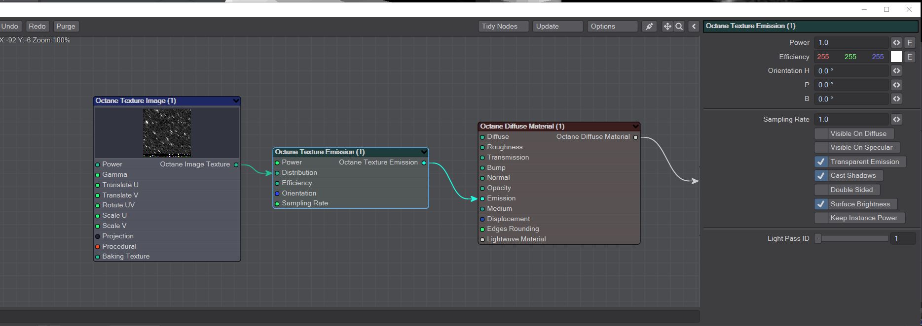

I suppose that you could use a setup like this one, using the texture emission node.
Thanks,
-Juanjo
baltort
Posts: 72
Joined: Mon Jul 07, 2014 4:00 pm
I would try something like Juanjo suggests, but maybe try connecting the baked texture to the Efficiency pin rather than the Distribution pin?
