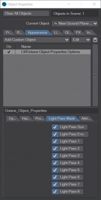

Could someone please point me how light linking works in octane for lightwave?. I only seem to find guides how to do it in C4D...
Lets say I need 2 objects and 2 lights, each light iluminates just 1 of the objects...
many thanks!

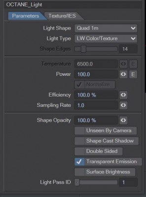

You can control the light passes that affect an object using the options available in the Octane custom object plugin. The light pass ID can be set for each light using the option available in the Octane_light parameters.
Hope it helps,
-Juanjo

Thanks a loot,
prety straight forward
somehow did noy see the object properties under the appearance tab
