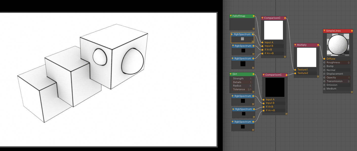

There's one in the LiveDB/Misc called, "line art," that can get you started. It's a bit more complicated than you probably need, but should give you some ideas if you take some time to dissect it. Personally, I use a combination of a Dirt (with Invert Normal checked) and a Falloff node, each individually choked with a Comparison node, then multiplied together. It's not perfect, but with a little tweaking in post, it does the job.
Simple Lines Shader
Simple Lines Shader

frankmci wrote:There's one in the LiveDB/Misc called, "line art," that can get you started. It's a bit more complicated than you probably need, but should give you some ideas if you take some time to dissect it. Personally, I use a combination of a Dirt (with Invert Normal checked) and a Falloff node, each individually choked with a Comparison node, then multiplied together. It's not perfect, but with a little tweaking in post, it does the job.
It works pretty well,
Thanks a lot
